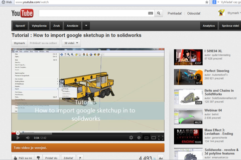

This theme has already been here, I have import some sketchup models in SW :
Maeba MC 285 Mini Crawler Crane in working mode and Maeda MC 285 Mini Crawler Crane in transport mode
I see that I must make a video tutorial.
Done, I will uploade this assembly so how it was exported that all can have a look how good or bad this tool work
Here is video tutorial : http://youtu.be/KyI-V4NLs28
Model is here : Tatra 815 crane Sketchup to SW tutorial
