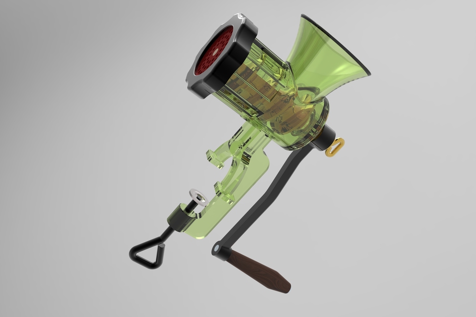

How to make animations in Pro/ENGINEER R5.0? Aleksandar Tijanic 17 Feb, 2012 12:22 PM Meat grinder ( Masina za mlevenje ) Masina za mlevenje.138.jpg 1 Answer EDISON PHOENIX Answered on 5 Mar, 2012 06:15 AM At first assemble your parts using connection tools like pin joint..,then click application in menu bar then go to mechanism , then you can apply inputs like servo motors .. Then run the mechanism .. Thats all..
