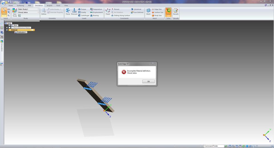

I'm testing a office table model in solid edge st4, and when i select any wood (Ash, Balsa, Pine, Walnut etc.) as model material i get a message "Incomplete Material definition". With other materials everything is OK. Of course, any help would be most welcomed.

It's because wood is an "othrotropic" material, and metal is"isotropic". I don't see any provisioins in SE simulation to do an orthotropic study. You should read up on the differnet material types before trying to run a solve. Imagine someone building an aircraft out of wood and runing a solve with an isotropic study........... SE did you a favor by not letting you run an iso solve on a ortho material! Hope this helps someone out there!
