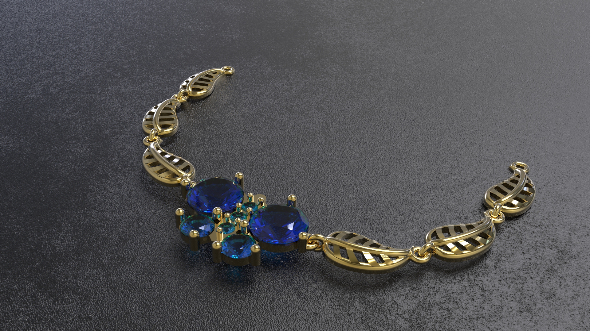

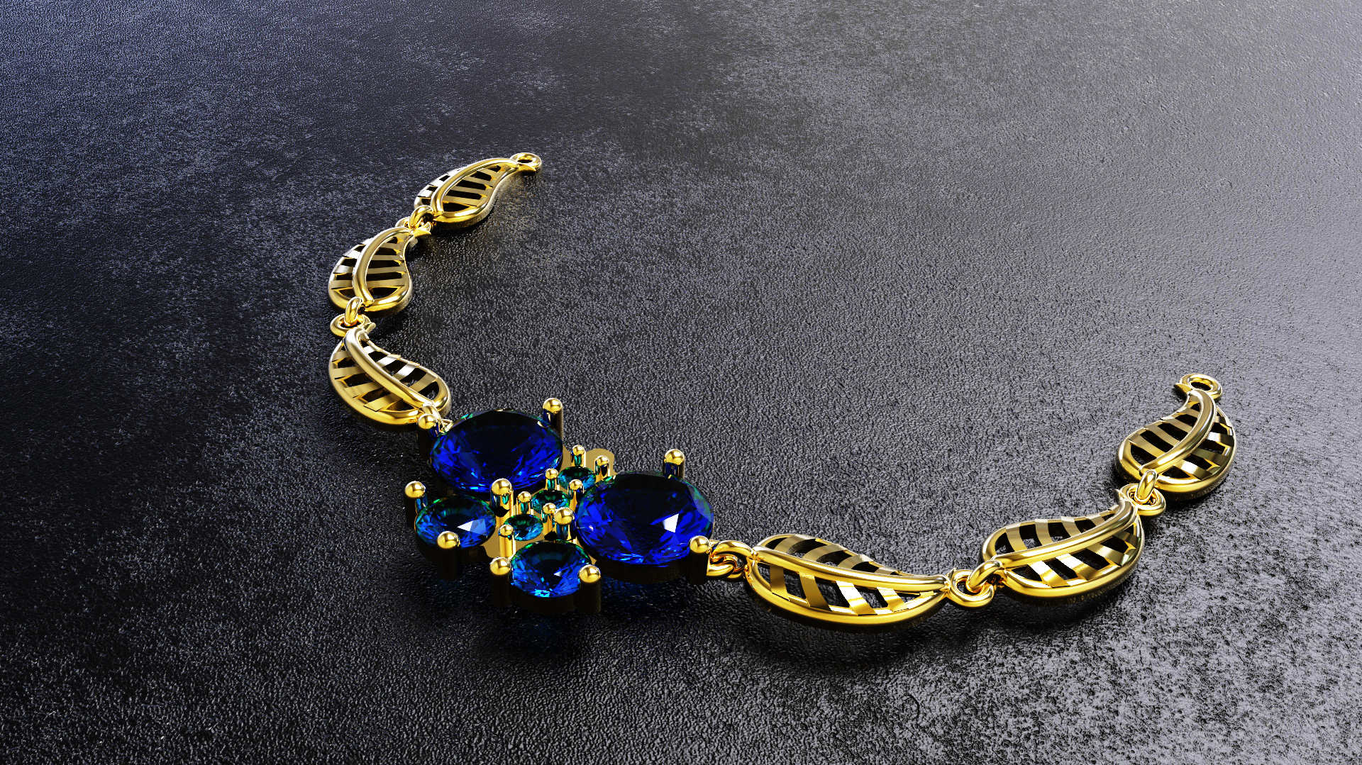

  • Jitender Chaurasia (JittuARTS)
    Jitender Chaurasia (JittuARTS) over 1 year ago
    I have simple used the gold material and GEM material available in Keyshot library, but the environment is a custom HDRI, which gives it more realism, at last post processing was done in Photoshop
