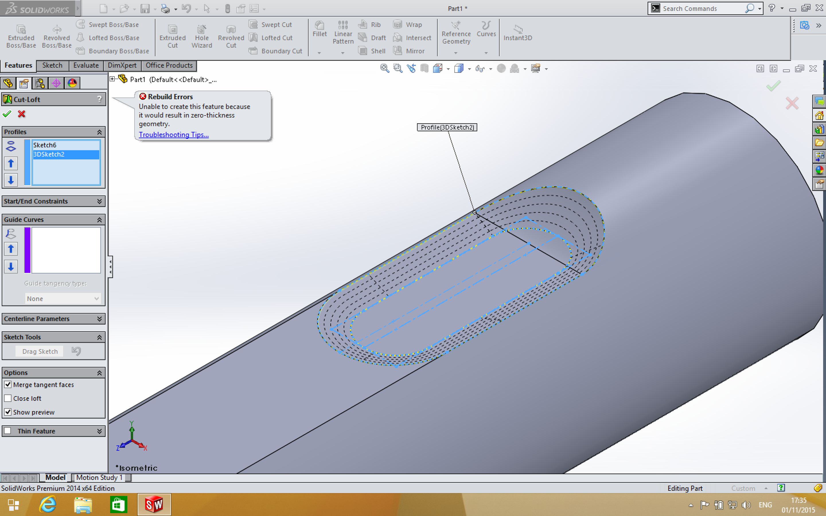

I'm trying to cut loft a 3d sketch and a 2d sketch.
This results in zero geometry thickness.
What can I do?
I'm thinking of offsetting the 3d sketch by 0.1mm so it wouldn't be zero, but I can't manage to do that. Help?

I made the model is SW2016, so uploading the result will not help you since your model was made in SW2014.
I would use a sweep for this though.
I'll attach some photos:
Answered with a tutorial: https://grabcad.com/tutorials/lofted-cut-3d-sketch-problem
