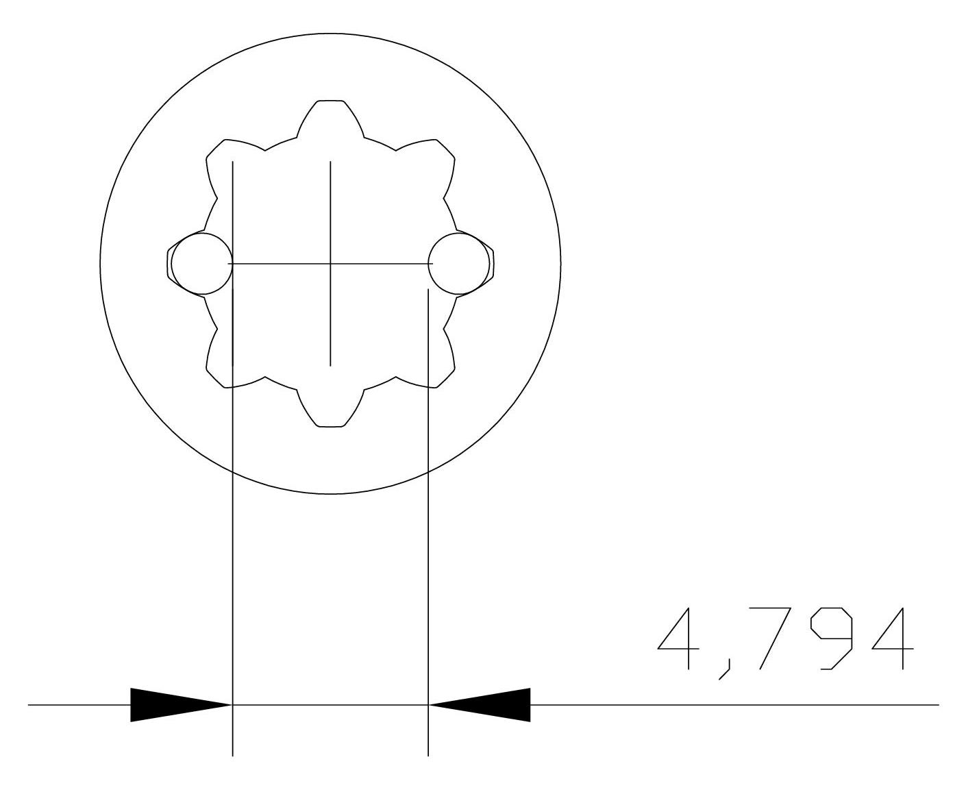

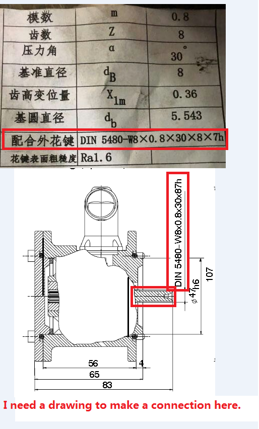

I need a spline joint DIN5480-W8X0.8X30X8X7h, detailed 3D drawing to make connection with encoder.
The encoder was from KUKA as attached.
I am not familiar with this kind of connection, so is here anybody could help me make a drawing and send to me via mail (qmhyjh@163.com).
Thank you very much!

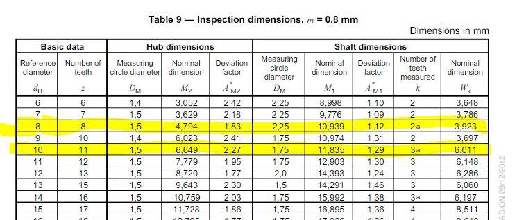

Your shaft has 8 teeth with an involute profile, You can verify with a measure like that you can view in the attached fig 1 . The balls or pins have a diameter of 2.25 mm. The hub will have an inspection dimension like you can view in fig 2. In this case, the pins or balls will have a diameter of 1.5 mm (see attached fig 3). Shaft and hub dimensions you can see fig 4.
An involute profile doesn't have a simple drawing. I uploaded a 3d model
DIN 5480 shaft and hub W 8 -0.8
I hope it will be useful for you
Dear Mark, thank you very much for your answer.
DIN5480 should be a technical standard for such kind of spline.
Now my question, I just want make a mating external spline where assemble the encoder on the shaft.
Don't know your application but there are a number of companies out there with splined clamping hubs built to DIN standards; KTR's rotex hubs for example. Certainly a lot less expensive than making one.
https://www.ktr.com
Good luck
Thank you very much for all of your answer.
For my application, I just want assemble the KUKA encoder on the special shaft to measure the rotation. So I need a drawing to make a hole where assemble the encoder as attached.
Hi, how do I calculate the tolerance of the control dimension over the ball? My shaft with spline W10x08x11x7h Ø11.835 and W8X0.8X30X8X7h Ø10.939
