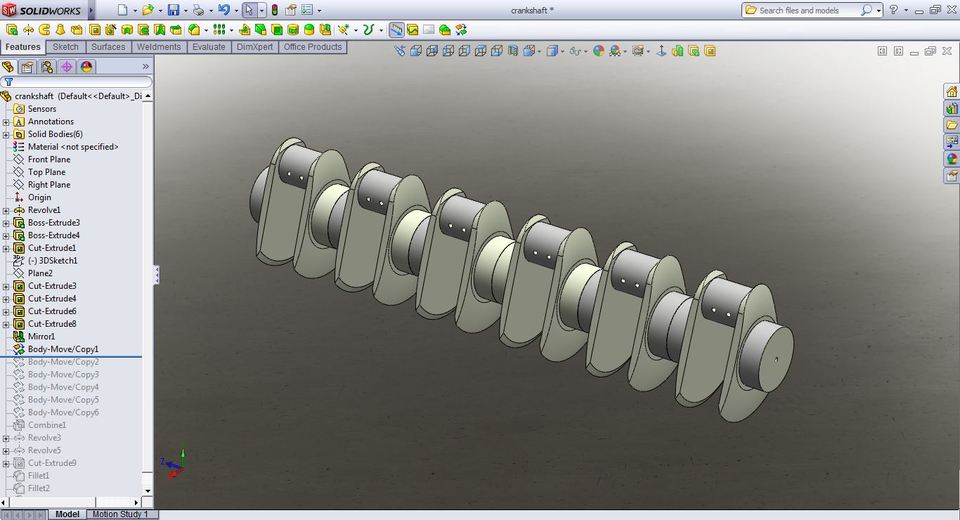

crank

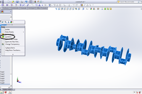

Answered with a tutorial: https://grabcad.com/tutorials/tutorial-how-to-make-engine-part-3--3

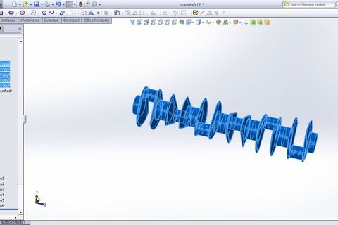

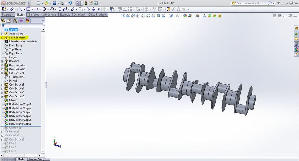

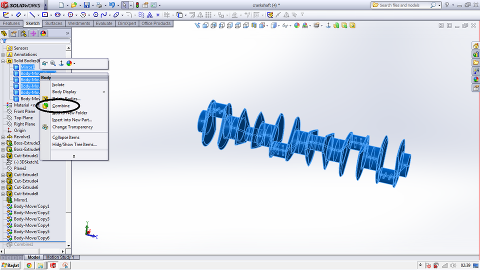

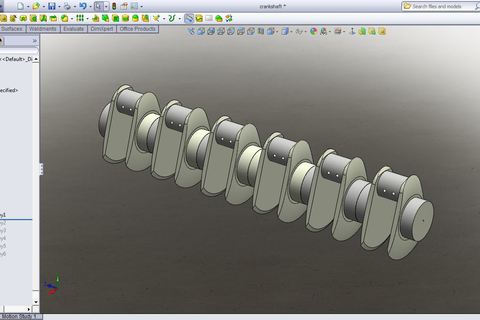

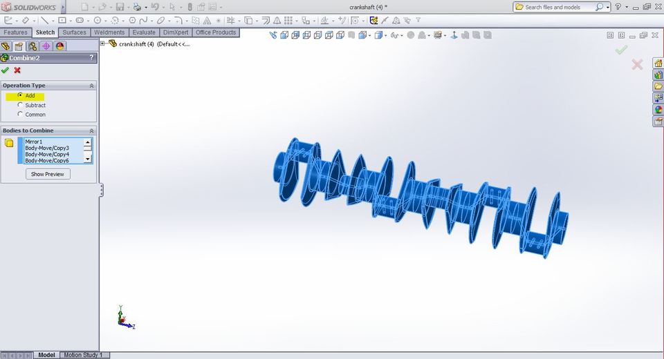

How to use combine command
Only if you have problem with the combine command, follow this tutorial. if not, go to part 4.

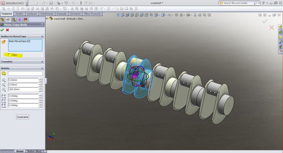

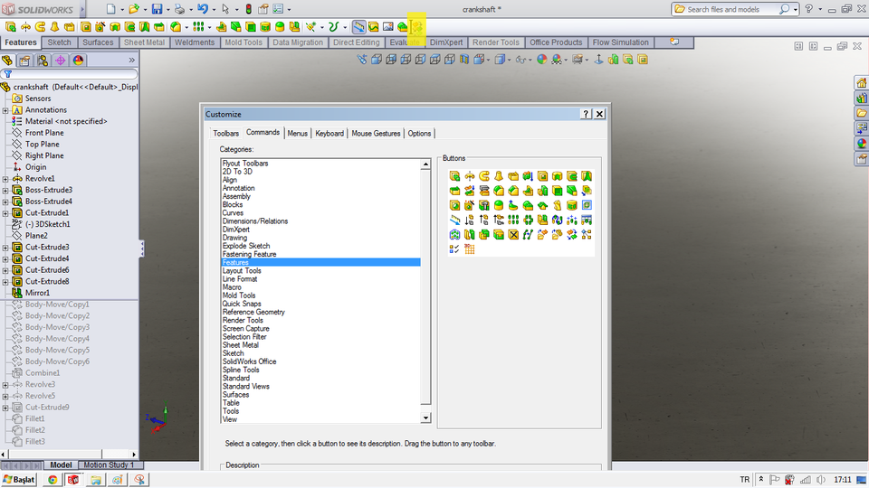

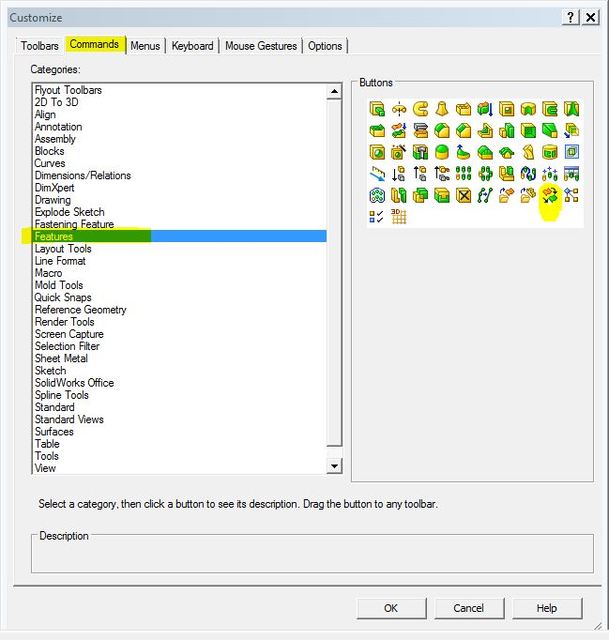

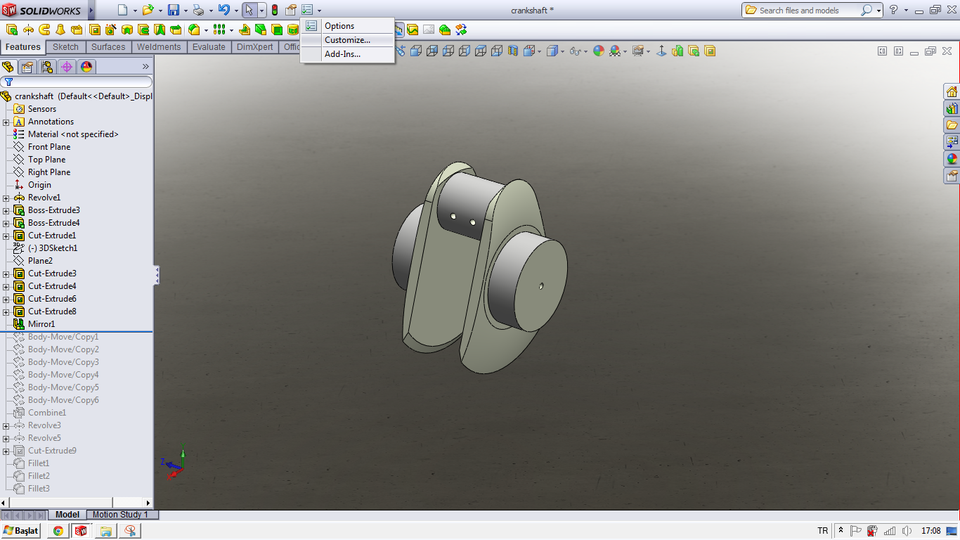

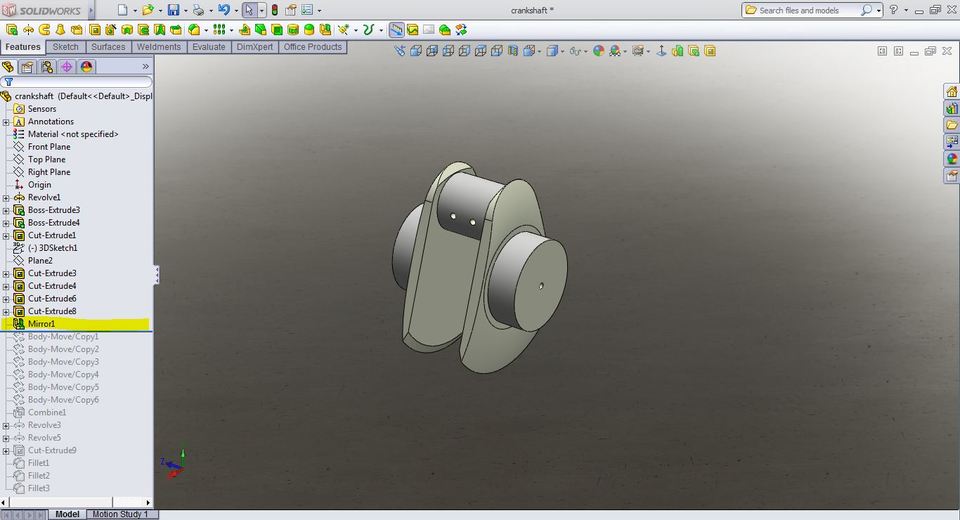

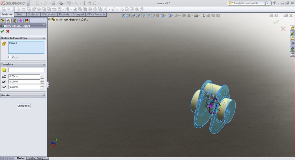

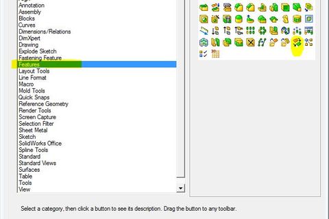

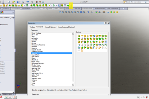

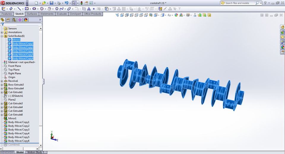

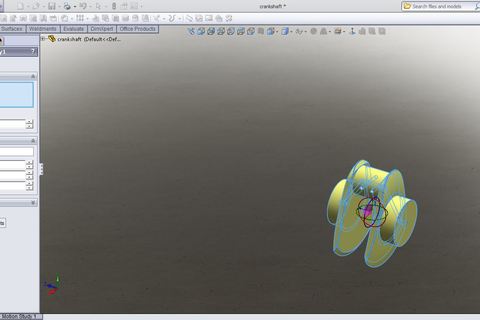

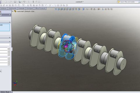

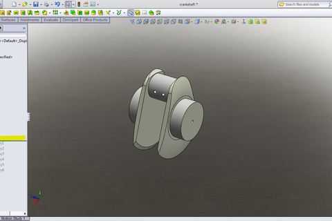

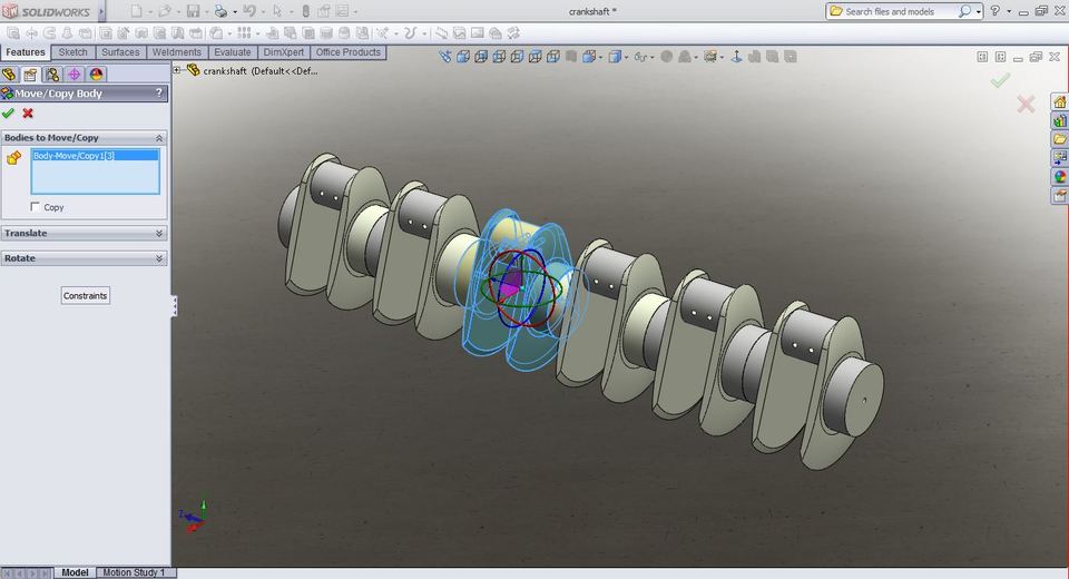

using 'move copy body' command for coping
(if you have a problem with this command, follow the tutorial. if not, go to next part)

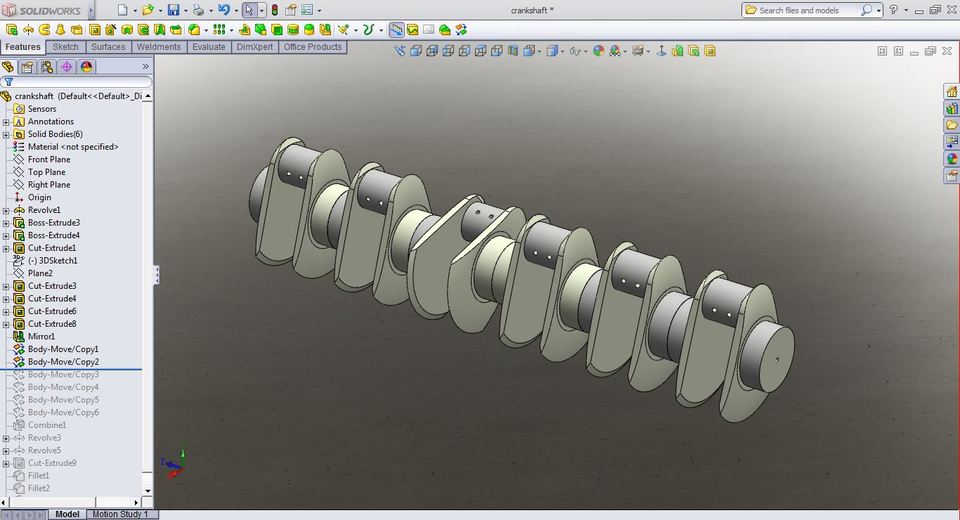

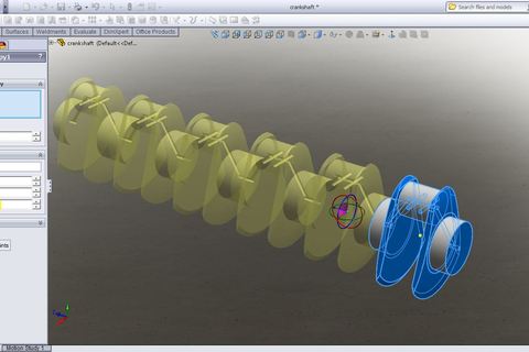

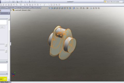

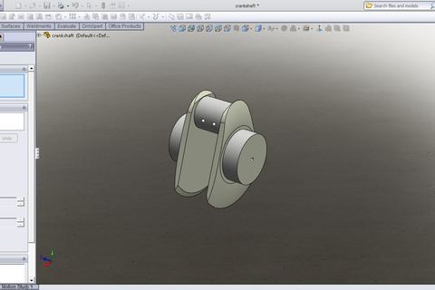

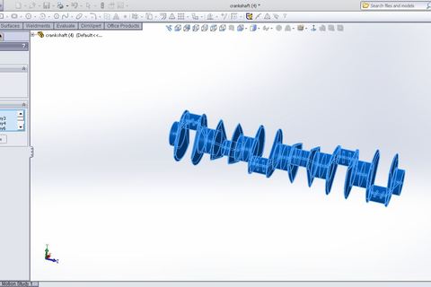

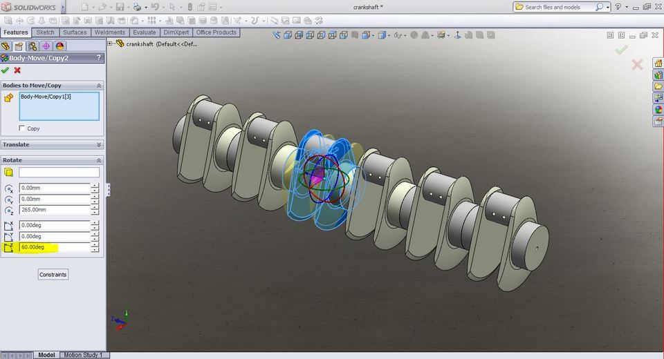

Answered with a tutorial: https://grabcad.com/tutorials/tutorial-how-to-make-engine-part-3--1

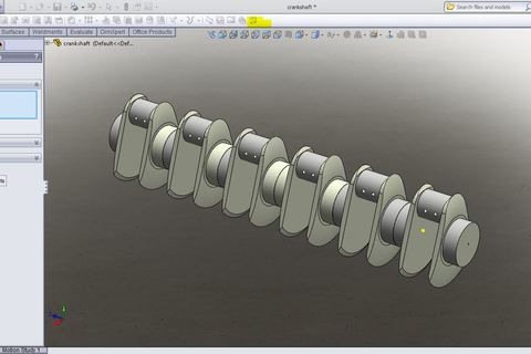

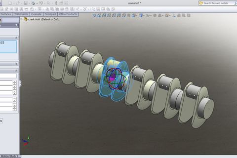

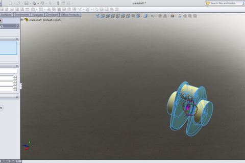

using ' move/copy body' command for rotating
Answered with a tutorial: https://grabcad.com/tutorials/tutorial-how-to-make-engine-part-3--2

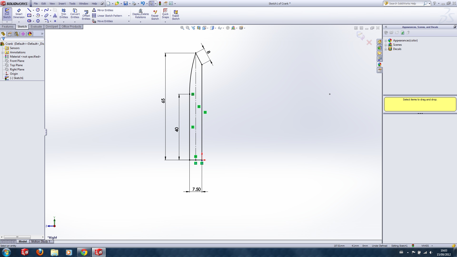

Step 1 wasn't very clear so I added these dimensions, if you have your own that look better, please post!

Step one is confusing, these dimensions work great. If you were unclear about it, try these.

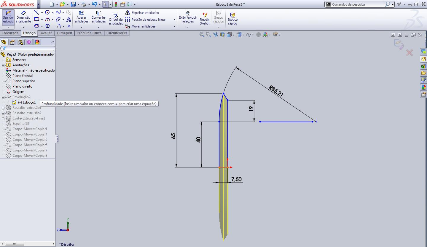

Measures that can be used in step 1. If you measure 8, such as spoken Hadleigh Murad, an error will occur in accordance with step 4. Use of these.

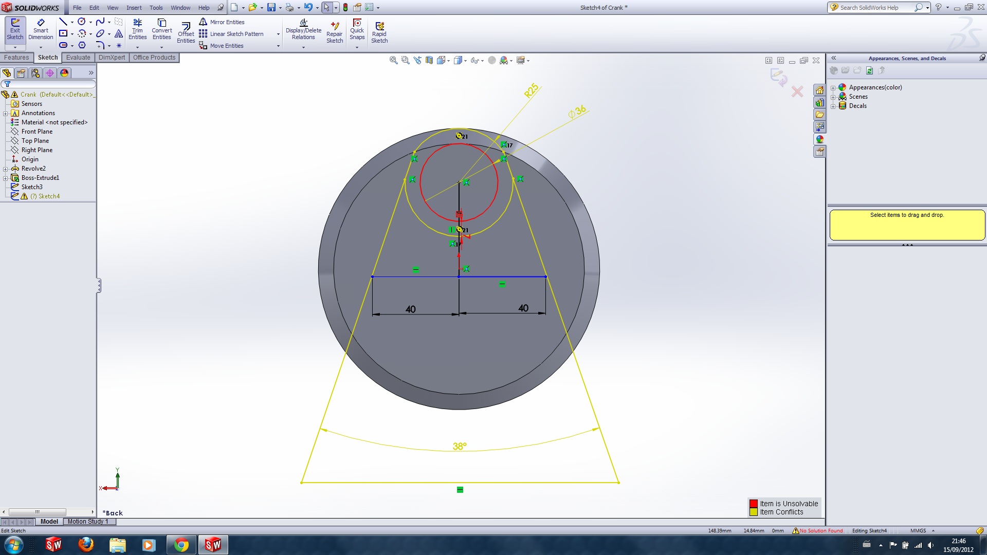

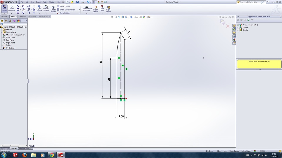

Also step 5 again, not many dimensions so i've added this picture if anyone needs advice.
(note: the sketch is over defined on purpose just to show the dims)

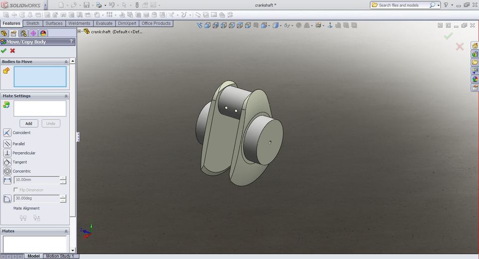

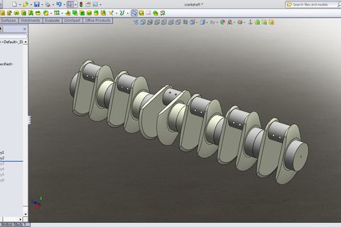

why do we give 95mm while copy/move command the crank...
Step 9
now we will change z coordinate. enter the shown value (95mm)... why 95 mm? pls tell me

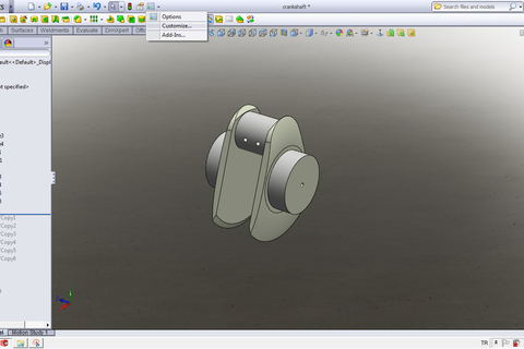

i do the pattern, so i have all 6 joints, but i dont know how to rotate the each single joint, how do i do in inventor ??
hey i'm working at autodesk inventor
how I can do this copy operation and the rotation I can't do also
