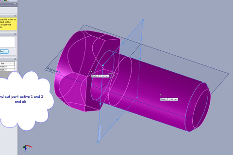

Answered with a tutorial: https://grabcad.com/tutorials/tutorials1-how-to-model-standard-screw-in-soldworks
The screw design should be noted that these points
THANK YOU

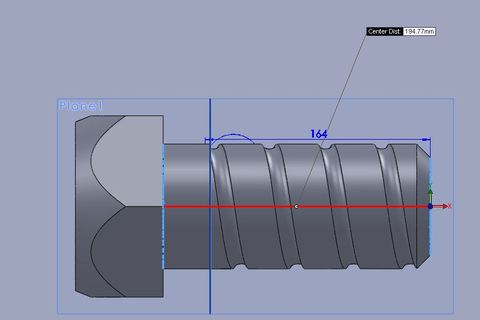

That's not standard. Standard screws have an included angle of 60 degrees with a crest of one eighth of the pitch, and a trough of one quarter of the pitch.
