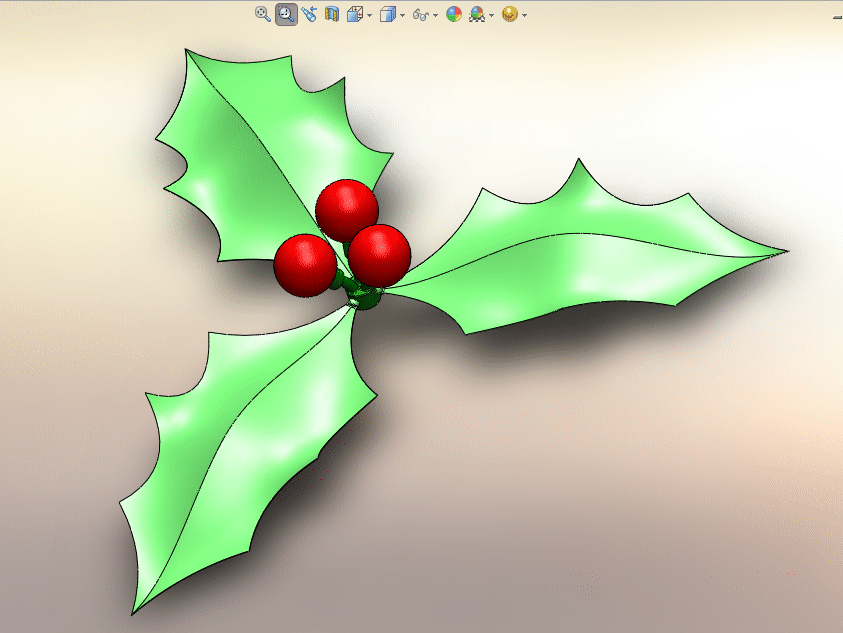

An easy way is to start with a flat half-leaf without the stem and use the bend tool.
Attached is a leaf modeled using this method, but using displacement mapping and stuff to get the texture, instead of just a decal. Think I left the stem out of this one because the plant I put it on had them already.
Answered with a tutorial: https://grabcad.com/tutorials/what-would-be-the-easiest-way-to-model-green-leaves-see-picture-in-solidworks--1
Comments 0
Thank you David and Cemal! Can't wait to go home and do it myself! Excellent tutorial!
