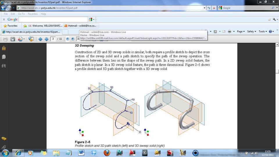

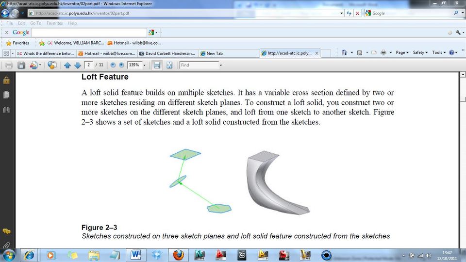

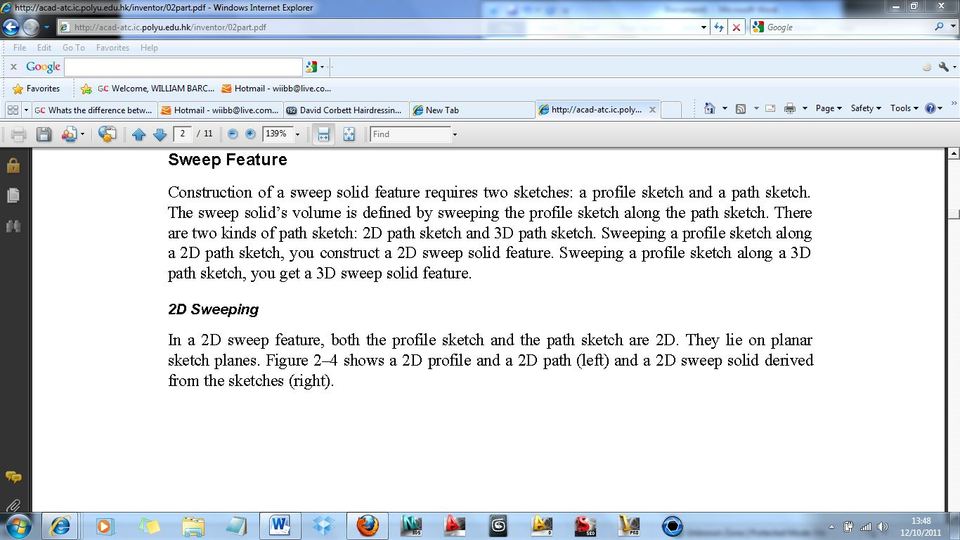

Whats the difference between a sweep and loft?
2 Answers
http://acad-atc.ic.polyu.edu.hk/inventor/02part.pdf
This will tell you all about what you can do.
What is easier? well that all depends on the sketch.
