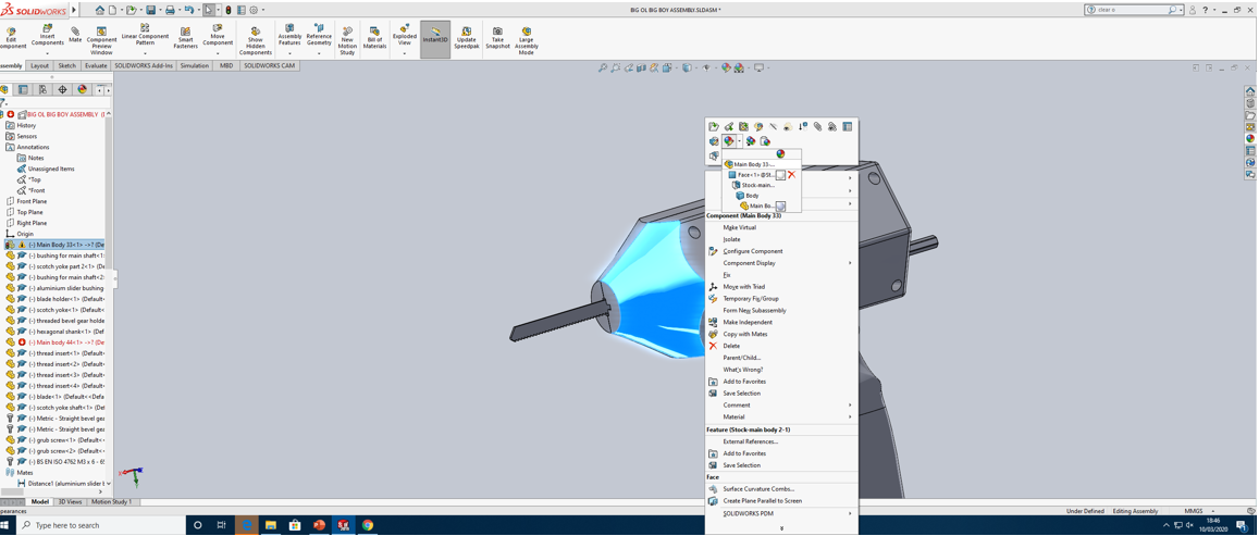

I am trying to change colours on individual faces of my components in solidworks so that I can change them in keyshot, but once I apply the colour it does not show even the part even though it states that the face is that colour... If someone could help be asap that would be great as it is for a university project which is due in in two days.

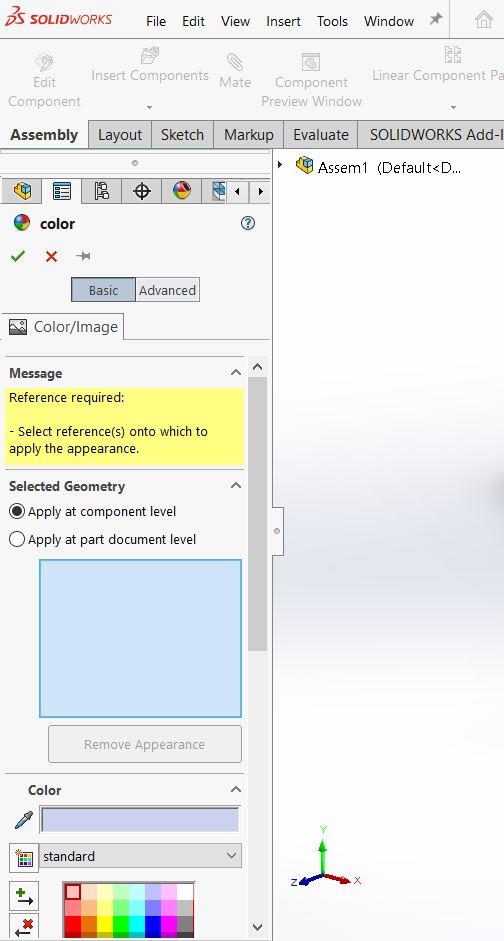

Yes I have had this issue after doing a reset default settings.
In this case Assembly model colors are overriding individual part colors.
Click on edit apperance.
Your colors propperty manager should show on left hand side.

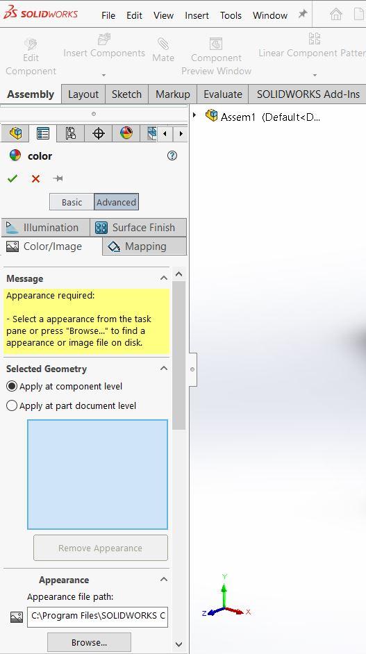

There are two tabs under color propperty manager (basic and advanced).
Click Advanced
Then click Remove Appearance
This should make individual parts colors show in assemblys or have priority.

As others have noted.
The problem here is an appearance has been applied at the assembly level.
This appearance overrides any appearances applied at the part level.
You need to remove the appearance at the assembly level.
Right click on the assembly in the feature manager tree and then click on the down arrowhead next to the red/blue/green ball with a pencil and select remove all appearances.
You can reapply appearances at the part level to get back original appearances for the assembly.
