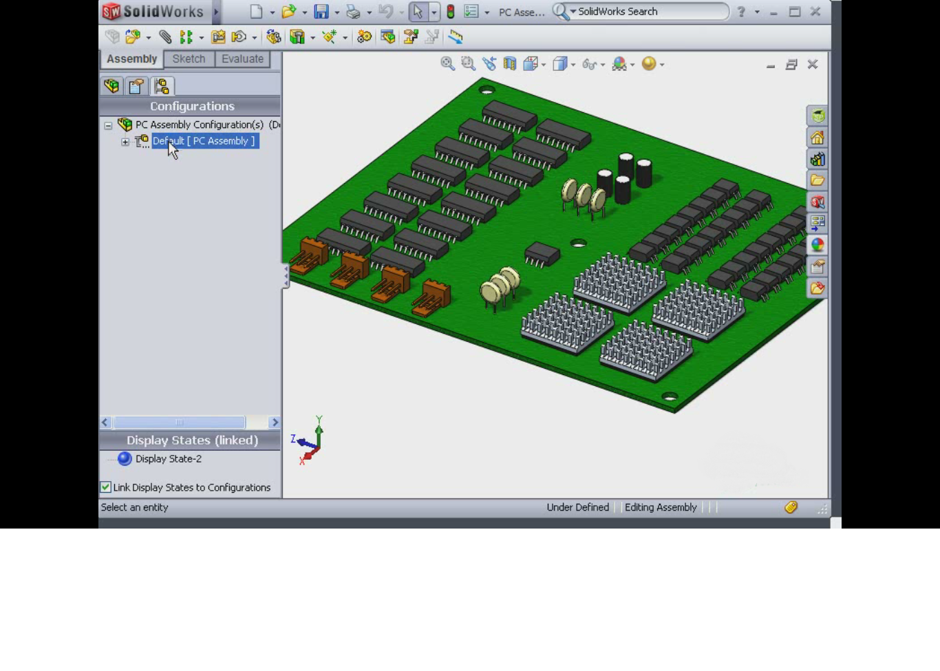

    click on configurations and right click on default written link
  3. Step 3:

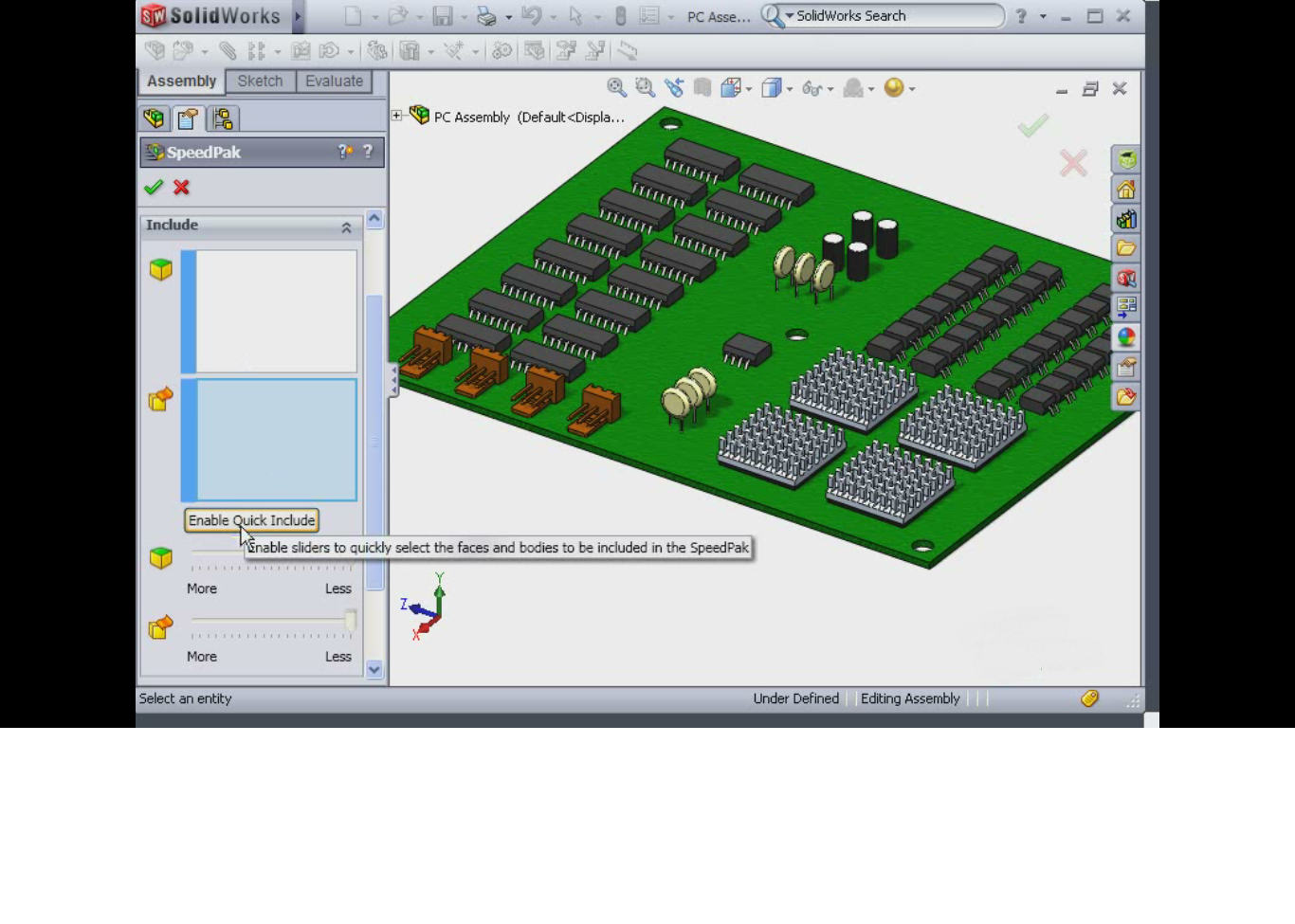

    then click on Add SpeedPak
  4. Step 4:
    this step you can manually select the faces and surfeces. instead of this, you can click on enable quick include button and it selects automaticly
  5. Step 5:

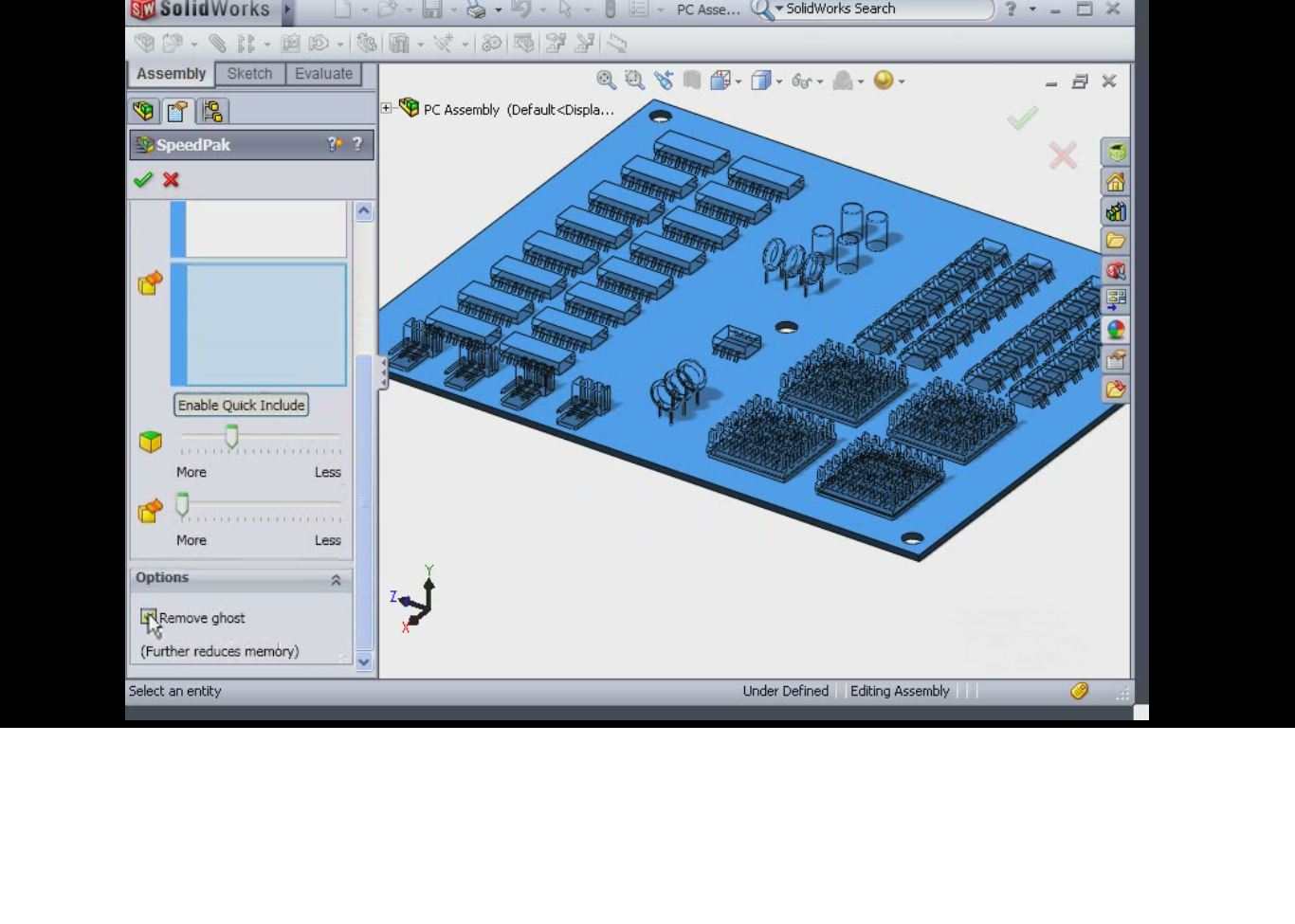

    now you can set degree of transparency
  6. Step 6:
    if you click on remove ghost button it will further reduce memory. but it means the components will hidden. so I didnt click on it
  7. Step 7:
    as you see, the component diseppear when mouse came near.
