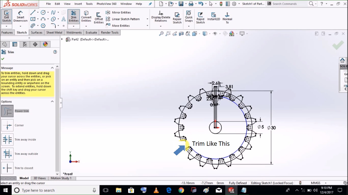

Step 1: start with Sketch
Step 2: use offset command
Step 3: create tooth line and give dimension
Step 4: Apply fillet like this
Step 5: use circular pattern
Step 6: use trim (power)
Step 7: Extrude
Step 8: sketch on left face and use cut extrude
Step 9: mirror
Step 10: fillet on corners
