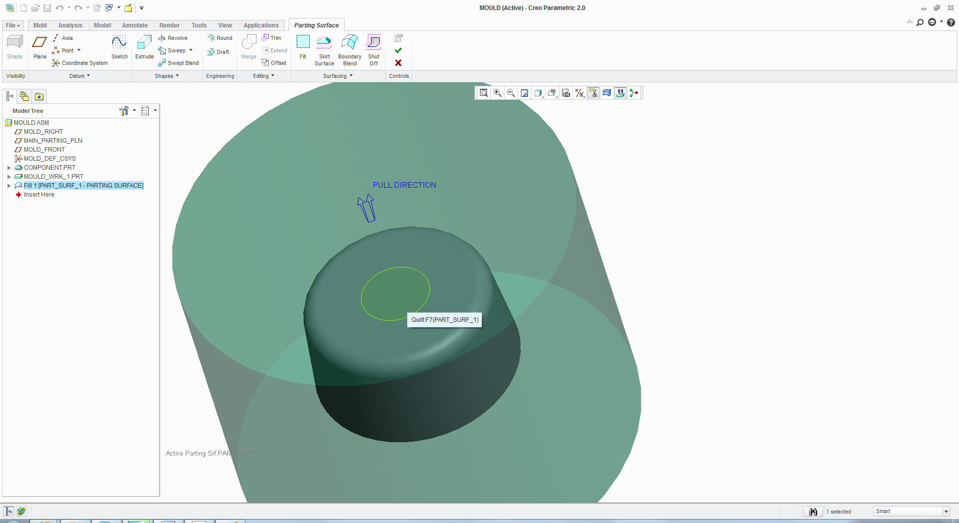

  7. Step 7:
    Next step is to create parting surface
    In this example , we need only 2 parting surfaces (using "fill" option)
    Click "parting suface"--- "fill"--- use the edges the hole to create flat surface as shown in the image
  8. Step 8:
    Next step is to create 2nd parting surface
    Follow the same procedure of the previous step and create a parting surface as shown in the image
