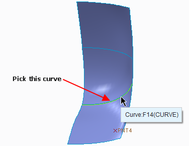

    Now we will create another datum point so again pick Point icon  on the Model tab.
    Pick the following datum curve as reference.
    Pick Next End icon to change the measurement reference to right end of curve
    Change the Offset option to Real and enter 55 as the Offset value as shown below.
    The preview will appear as shown below.
    Pick OK  to complete the definition of datum point.
    Again pick Point icon on the Model tab and select the following datum curve as reference.
    Change the Offset option to Real and enter 25 as the Offset value as shown below.
