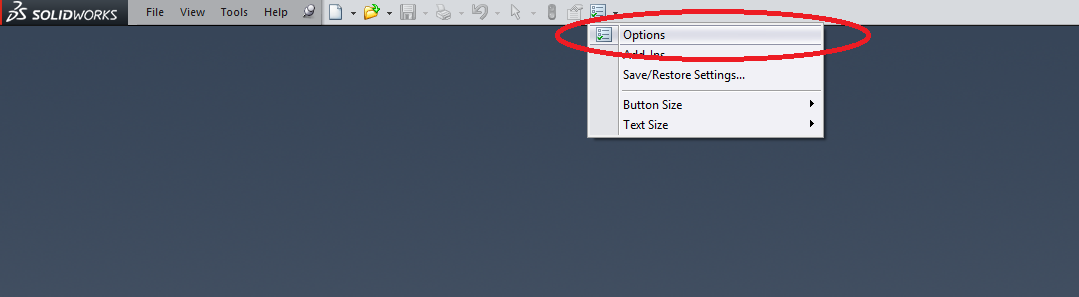

    By default, Equations are not visible at Design Tree, we must start our tutorial by activating it.
    First of all, open your SolidWorks and before making any new part, go to Menu and choose Options.
  2. Step 2:
    This will open SolidWorks System Options.
    Once there at left list choose FeartureManager.
    At right place you can see Equations, click the drop down menu and change it from Automatic to Show.

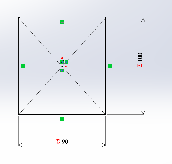

    For next step, create a sketch and make a rectangle (in any plane you want).
  13. Step 13:
    Now time to link the dimensions to the values you previously set up.
    Use Smart Dimension as usual, but instead of the values type the signal "=" (equal), doing so, like the picture, the pop up to link the value showing the Variables you already made will show.
  14. Step 14:
    Click on the option A (100).
  15. Step 15:
    The result should be this.
  16. Step 16:
    Press enter and you will see it changes the A for 100, but not like usual it has a Globe icon on its left.
  17. Step 17:
    Press enter (or click on the green check) to close the dimension edit, and you will see the result. Note that the dimension has the Equation Symbol before the Value, it means that your dimension is linked.
