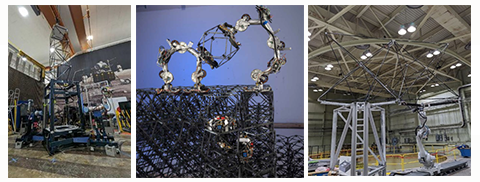

NASA Robotic Assembly Projects (TLT, ARMADAS, PASS)
Recent efforts within NASA’s Robotic Assembly Community (e.g., ARMADAS, PASS, TLT, VSAT) have developed modular structural elements and multi-agent robot systems for building complex lightweight structures, telescope array backbones, and tall towers in space. The teams have demonstrated the potential of these construction methods by building various structures with assembly agents ranging in complexity from astronaut assembly to teleoperated robotic arms to fully autonomous multi-agent systems. These structures will need to be outfitted (i.e., sub-system integration) for functionality, including power, data, fluid, gas, and other utility lines, solar panels, insulation blankets, other functional modules, and more.
The long-term goal is to have a robust and growing tool kit of structural units, functional modules, and robotic agents to help build the future of space exploration.

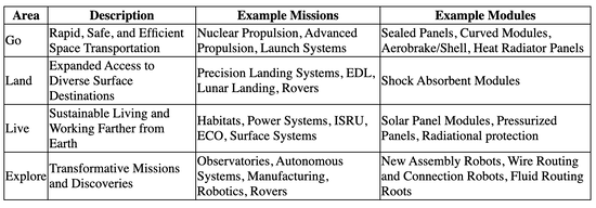

Structural Modules:
The are many types of structural modules that can be utilized to assemble a structure, participants are encouraged to use any of the example unit cell structures provided below, scaled to any size, as a starting point for their work. They may also choose to modify the unit cells to enable new capabilities or design new ones. Modules can be updated for better packing/handling/assembly/versatility, modified connection points or joining methods for robotic agents, etc. Participants must justify changes in mass, system complexity, etc. against the baseline design for the challenge and explain why the modified design is more effective for completing the assembly and outfitting tasks of this challenge.
NASA4

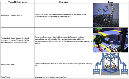

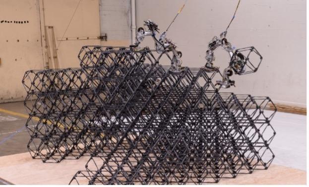

Robotic Agents:
Many types of robotic agents have been designed to assemble structures, and they all have their use cases, advantages, and disadvantages. You can assume for this exercise that the infrastructure is in place to support operations of these agents but should justify and explain their operations.
NASA5
Control System:
The control systems consist of autonomous algorithms and software to help control multi-agent systems and adapt to changing conditions. It is not in the scope of this challenge.
Outfitting System:
The current generation of robots excel at building modular structures current generation of robots excel at building modular structures from a basic set of components but do not have the capability to add the wiring or conduits that will need to be installed to outfit the structures for operational use. When supplied with a set of basic building blocks, specialized robotic agents can autonomously assemble large structures. Currently the ARMADAS project has developed inchworm type robots for installing cables, and the PASS project has developed algorithms for routing cables using serial manipulators and soft continuum robots.
Now the challenge is to demonstrate the installation of modular electrical connections and piping for utilities like fluids and gases using robotic manipulators. Cabling and piping should follow the same modular architecture where a basic set of components can be installed and connected to transport electricity, data, fluids, and gases using robotic systems. Installation of new functional modules that add capabilities such as interfacing with uneven terrain, connection of payloads, paneling to a system will also need to be developed. Simple and effective connection points will be a key feature in that they must be robust and allow robotic connections. Submitters can focus on the individual components that can be installed and connected robotically or they can focus on the robotic system that installs them.
An example design reference mission for outfitting could be a tower with vertical solar arrays on the Lunar surface. After the tower is constructed from modular structural elements, electrical power cables must be routed to the panels so the energy can be distributed.
NASA6

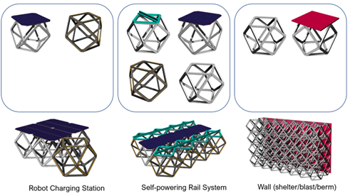

Example kit of modular structures and outfitting elements
