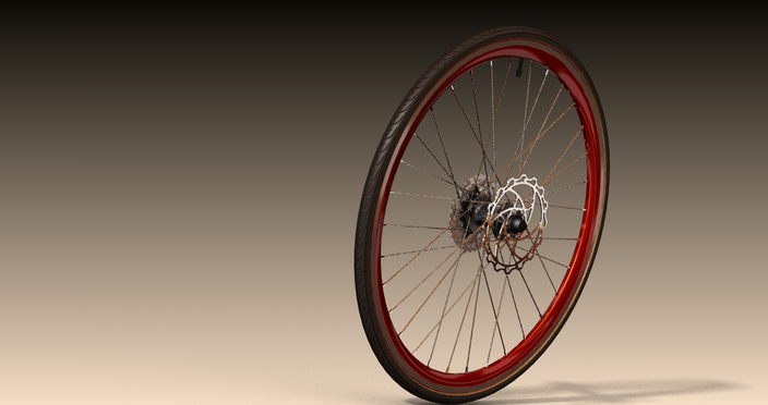

A complete wheel with tire, valve, 3X laced spokes, Shimano XT cassette and disc brake I grabbed here :) The hub is just one of the many hubs I made based on the same basic design, looks a bit like the 5xx series Deore, not an exact replica. This model is a part file created from an assembly.

    Are you sure this is a 26'' wheel? It looks like 24'' to me.

    It's a 559 rim, so, it's 26", sure, the outside diameter with 1" tires does actually give 23.97" but nominally, it's 26" :) Not my fault one can choose tires from 1" up to 2.125"...
