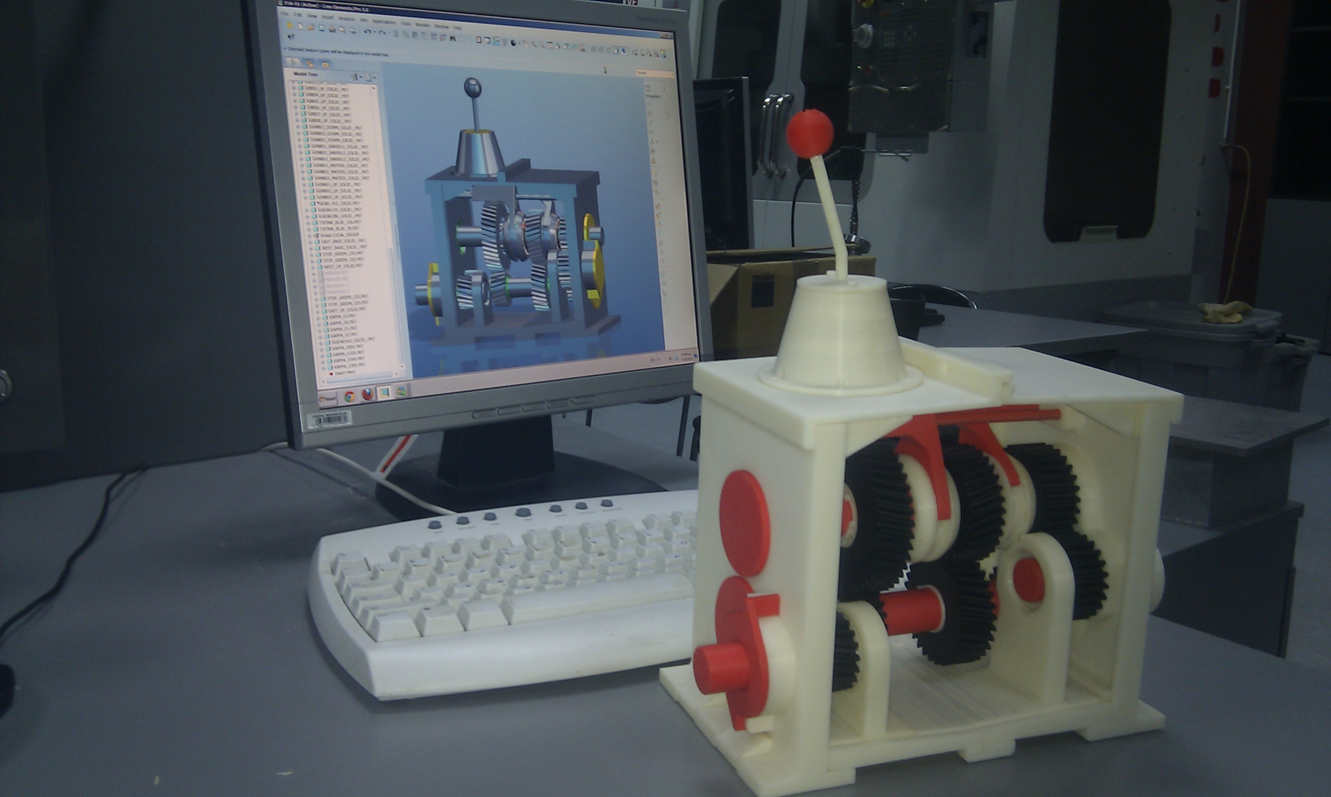

Project for Technological Educational Institute of Crete.

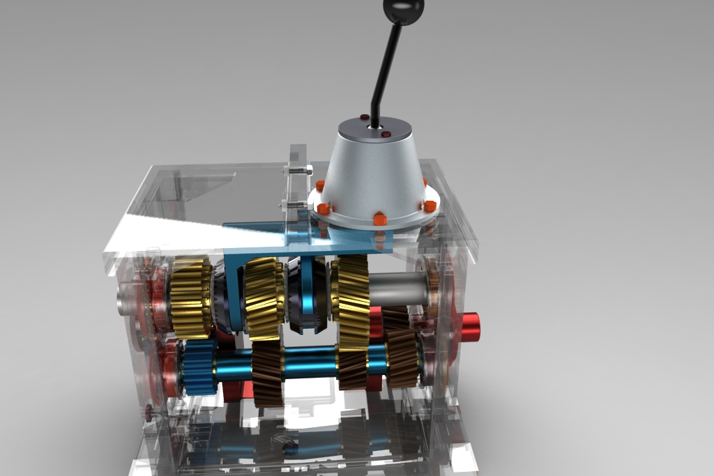

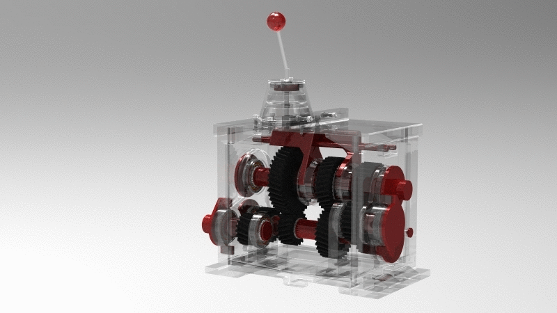

Synchro Gearbox designed in pro/engineer using skeleton model, gear ratio can be controlled via excel.
Gearbox printed using Dimension elite and bst rapid prototyping Printers.
Printed at 0.182 (scale)

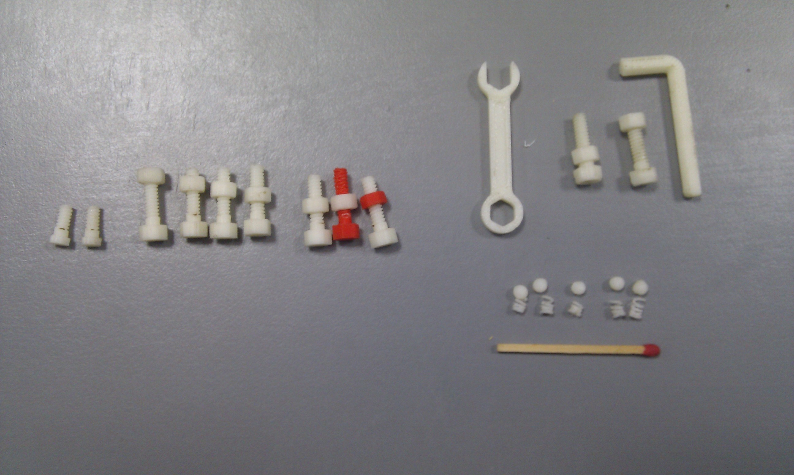

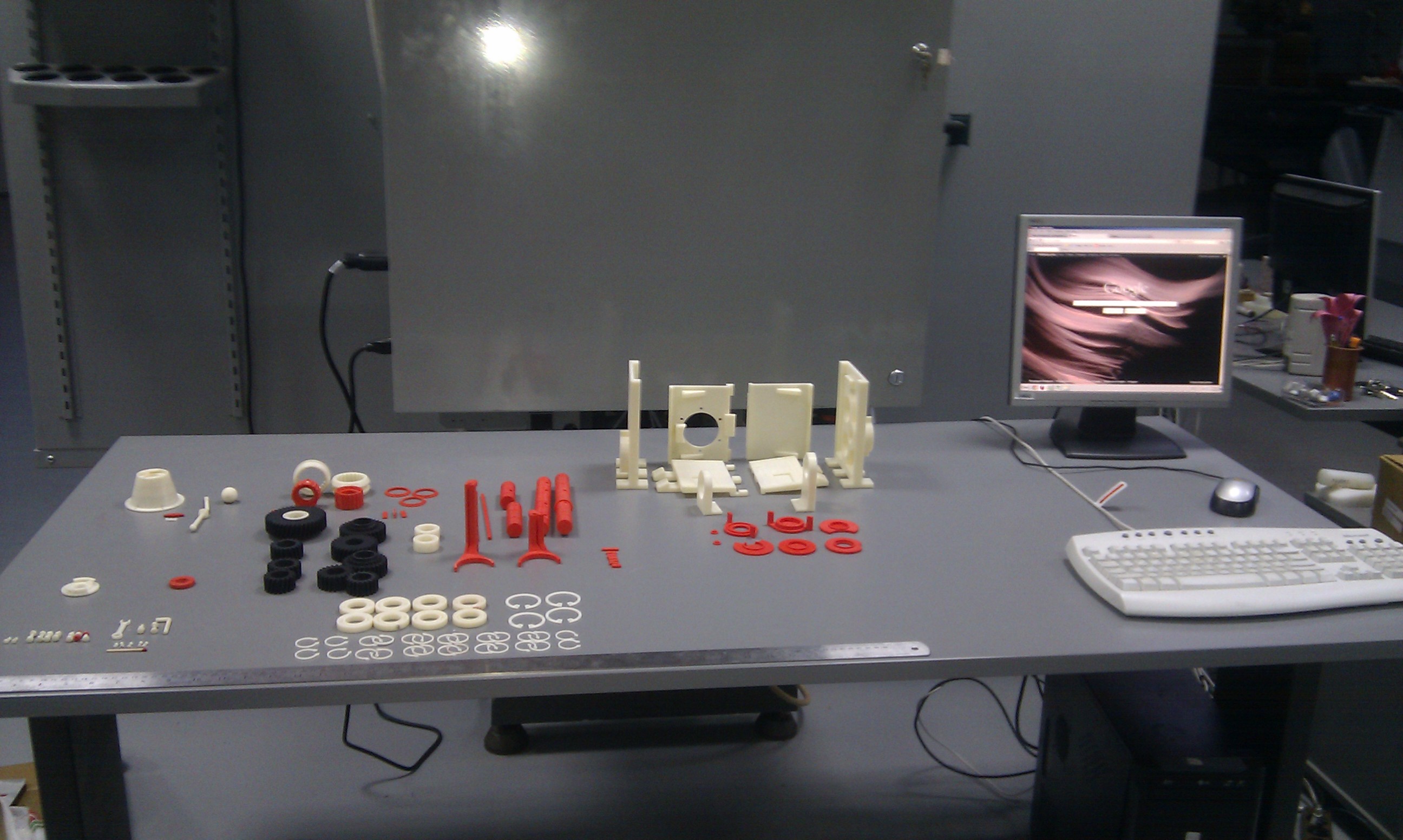

Quantity of printed parts: 142 (ball bearings are functional and printed as one part)
