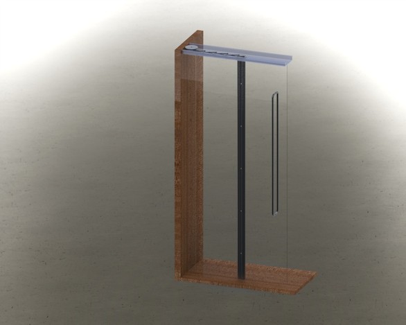

Hinge made ​​entirely of stainless steel, maintenance free.
Based on a four bar mechanism.
The concept is to eliminate the wind resistance by folding the glass door against the wall.
It is proposed as an option to build a the prototype and evaluate the user acceptance.
During the simulations, with a force of 30 N, you can open in just 2 seconds.
