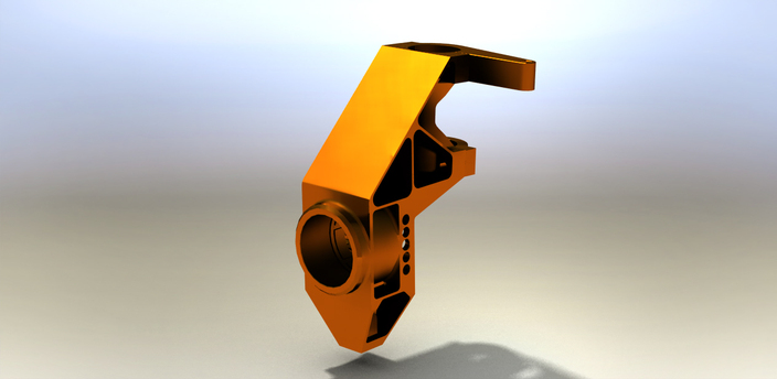

This is a front magnesium upright that Audi made for their S1 rally car.
Thanks, but this isn't my design. This was the actual uprights made by Audi for their racecars. I did however make the model from the actual part.
it seems that there is missing brake caliper attachment points
The caliper bracket is a separate piece that bolts to the side. This was done to accommodate different calipers without changing the upright.
