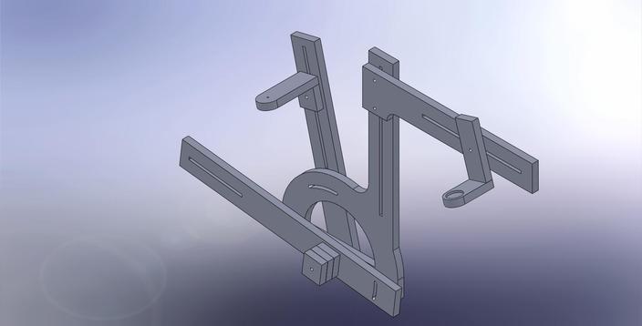

Bicycle frame jig, mdf
The goal was to design a jig which could be built with relatively simple tools(or cnc machining for greater accuracy).
Material was 19mm MDF.
All the parts were joined with M6 bolts and the rear axle was made out of M10 threaded rod and nuts.
Managed to weld 2 aluminium frames with it.

    thanks for the model I'm gonna look in to it and look if it's suitable for the mountainbike I want to build or adjust it.
