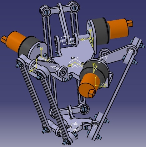

Manufactured on a CNC for being used in a vision-guided robotics project. Simulated and controlled in SimMechanicsand MATLAB, and analyzed in Ansys Transient for determining it's dynamic behavior.
Export as ACIS, but I not recommend it. Because you may not be able to model contacts and joints by that way. I had exported it as igs into Workbench Mechanical.
