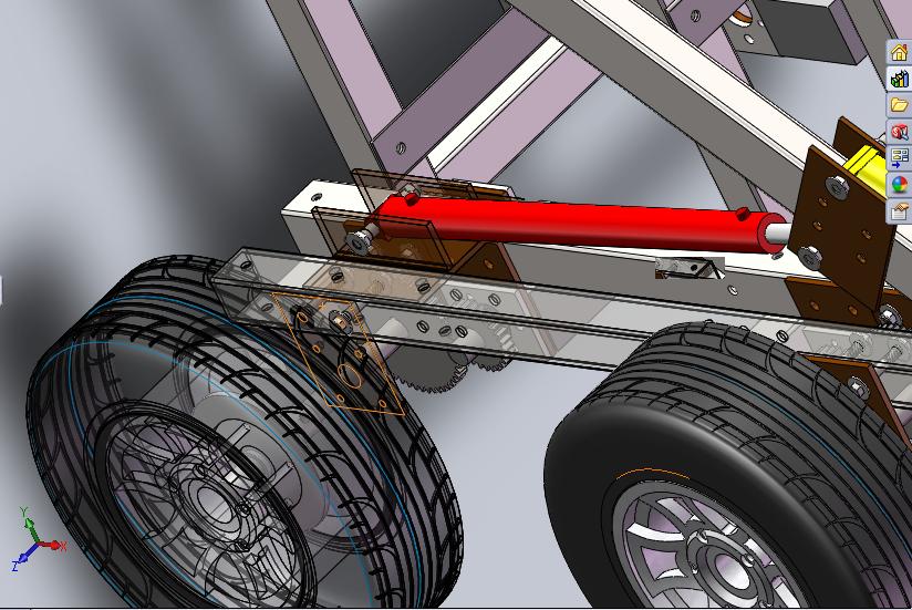

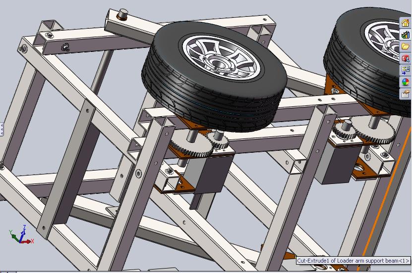

Feed Life traciv (lt3 76inch long) By johnny on 12 Dec 20:52
The torque is reduce by 30-50%.
And know, the Spur gear will be the weak point.
But you will lose 50%, of the speed . ratio 0.49
You may try to change the Spur gears but when you what to gain speed the torque will be higher ratio 1.49
you can built the Spur gears, using you laser or cutting torch.
for more specifications feel free to contact me

      The gears exposed to mud, rain and elements may not be a durable design. Have you tough about a casing to protect them?
      5 months ago
    • Daniel Flores
      Daniel Flores
      Take a look at the hydraulic drive system of a fork lift
      5 months ago
    • johnny
      johnny
      drawing was only a visual demonstration
      the gears will be closed in a box of oil, prolonging their life
      + + It will be sized according to the force
      hydraulic system and moving parts are enclosed in a box to protect them against impact
      i will update a picture more precise
      5 months ago

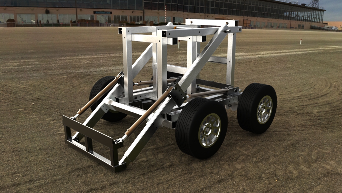

  • johnny
    johnny added a rendering 5 months ago
  • johnny
