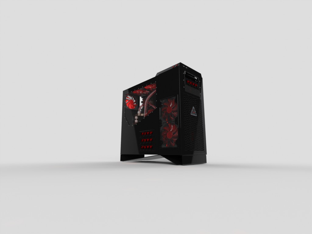

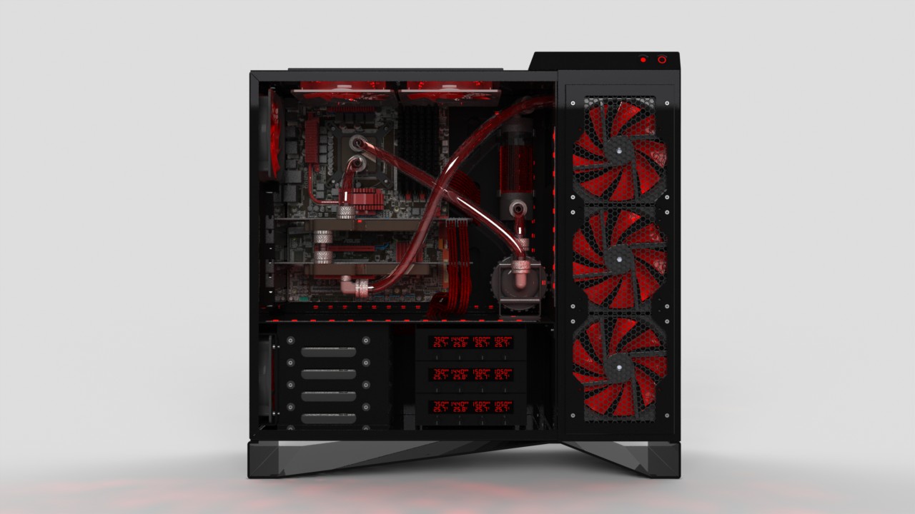

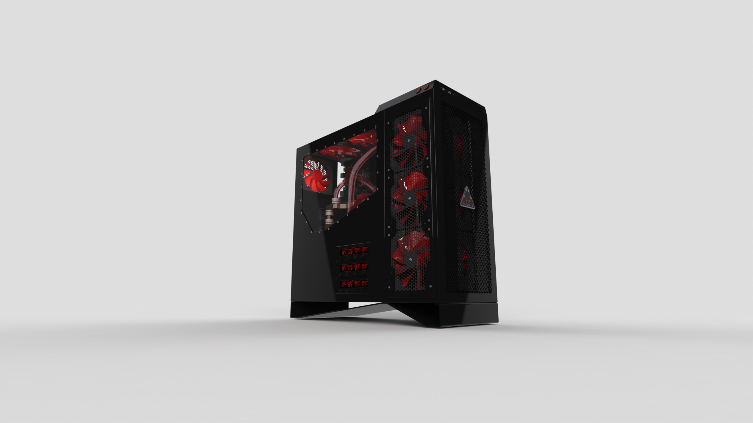

Originally designed for the Phobya Case design contest, this is my Idea of the perfect liquid cooling case for enthusiasts. I wanted the case to be easy to manufacture (even in a home workshop) but still provide unparallelled cooling options. The front bay houses 2x 360 or 420 radiators. The Radiators pull cold air in from the front and the hot air is blown out the sides instead of being circulated into the motherboard compartment.
Specifications:
Dimensions: (W x D x H) 243 x 567 x 570mm (520mm without case feet)
Compatibility: Micro-ATX / ATX
Case material: Aluminium
Drive bays: 3x 5.25in (six with optional radiator bay), 5x 3.5in bays
Fans: 2x 120mm/140mm roof (optional external radiator), 1x 120mm rear, 1x 120mm on 3.5in drive bay
Radiator mounts: 2x triple/quad 120mm-fan, 2x dual 120/140mm-fan, plus optional radiator bay
Features: Removable 3.5in drive bay, removable radiator bay, front slim drive bay, black anodised finish, simple sturdy design, lots of room for cable management, tough industrial look

      This is a Fantastic Design. I'm studying a Degree in Product Design. At the moment I use Rhino3D to Create My models. How long did it take you To Create this, and how much of it, Eg the Components of the Computers were Pre-made downloads.

      Thanks Martin, glad you like it. It took me probably 40-50 hours to model. Now the design went through a lot of changes so the actual modeling for the final version was probably only 10-15 hours. Most of the internal components (motherboard, HDD, pump, fans) were not modeled by me but all of the actual case components, the reservoir, and fan controller were modeled by me.
