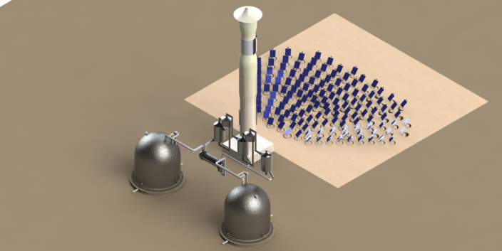

this is a normal solar power plant and the various important parts.
for people how want to download this solar plant pls go to the end of the page to get the link to download.
  • Emil Pop
    Emil Pop almost 3 years ago
    not very efficient, the main tanks and the tower need to be as close as possible to avoid long exposed piping to chill down the molten salts and solidify
