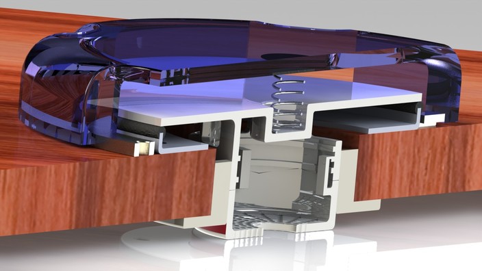

Ventilation window for yacht
Materials used:
The top cover - tempered glass / stainless steel
all other parts - durable plastic that is resistant to salt water and sunlight.
The opening mechanism includes only two extreme positions - open and closed.
The basic concept of the mechanism - the mechanism of a ballpoint pen.
Simple click on the button below the opening and closing the lid.
Indication of the closed position - the red line on the button below.
The lid, which closes the inlet turns into the opening and closing, which can be used with a transparent top cover and a display from the outside.
Approximate flow area is 38 cm2, but may be increased to 45-48 cm2 at the expense of reducing adverse movement closing the lid.
The top cover made of tempered glass creates an attractive appearance and increases the interior space under the lid.

    nothing special ...
    mechanism was born during a reflection on my engine, I pressed the pen many times and broke it:)
