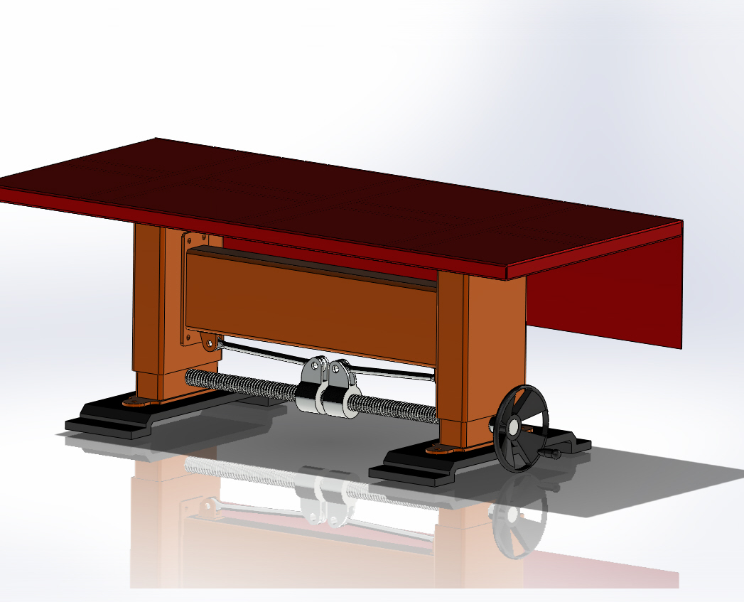

yes i agree with Hevi, the smaller beam angle is almost parallel with the threaded screw, so when you start turning, the joint might seize due to poor mechanical advantage. Need to angle the beam at maybe 30-45deg for this work properly. But neat idea!!! Nice rendering
Greg is right - 30 degree is a minimum must...
5 months agoGreg is right - 30 degree is a minimum must...

thanks for ur comments frnds ill try other option
