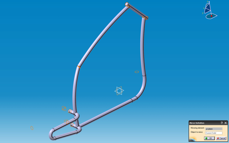

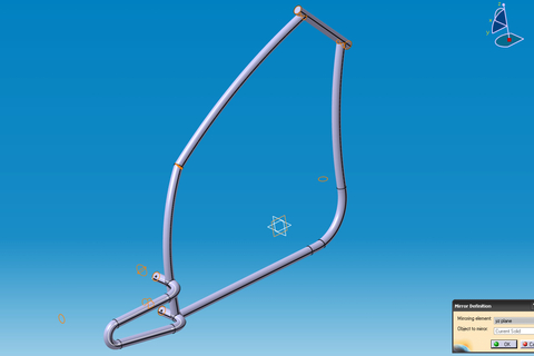

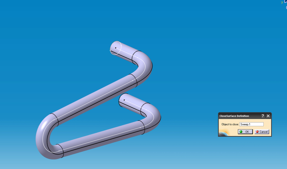

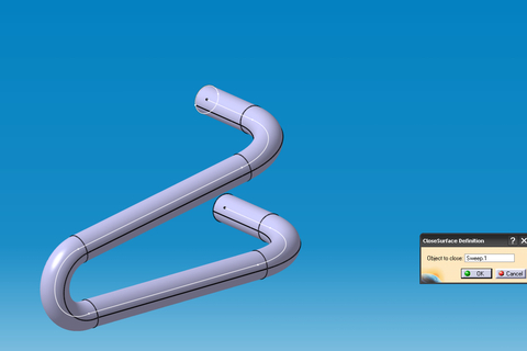

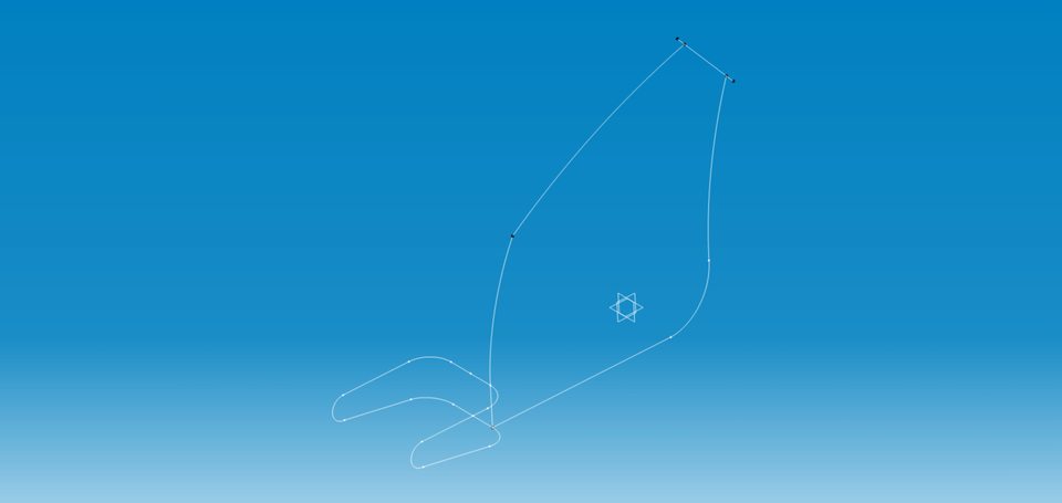

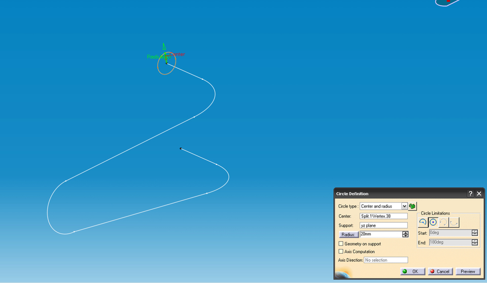

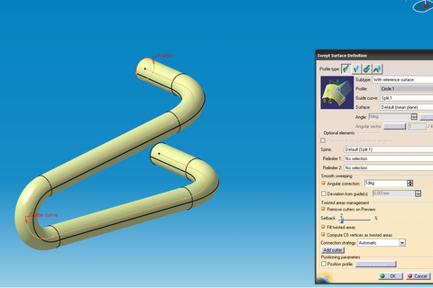

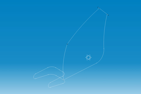

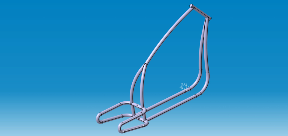

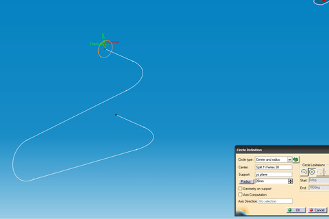

Its look like you had already done with most of design. ( I mean preparing splines ) You just need rib comment in Part design module to make them pipe frame. Because of some personal reasons i always preffer to use "sweep" command in GSD module rather than "Rib" in PD. Sweep comman providing many more options to handle with complex profiles. Then you can make them solid by "close surface" or " thicken" command. Iam adding my edition for your file. You can check my progress in "ONR_PARTS" body. I just tried to show its logic so steps are simple. You can have much better results with improving it. I wish that helps.

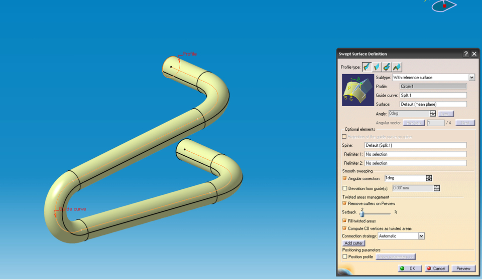

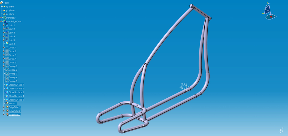

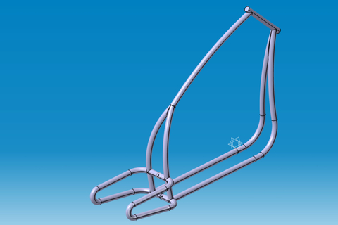

EDIT: Iam not sure whats problem about my data. I think reason is versiron differences. Iam using V5 R21 version of CATIA. Past versions like R20,R18,R17 couldnt open my file. So ive decided to provide more shots to describe my steps for data.
Answered with a tutorial: https://grabcad.com/tutorials/any-suggestions-how-to-model-a-custom-chopper-frame-in-catia

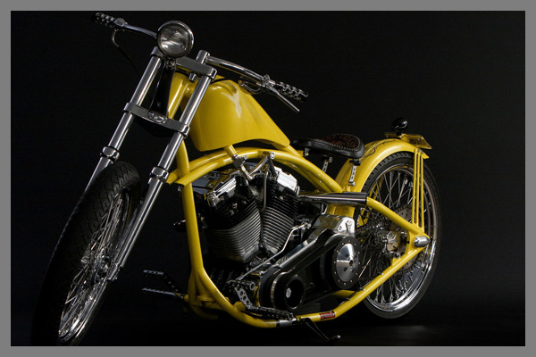

I've attached a picture of my custom frame / bike.
