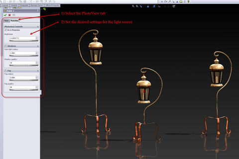

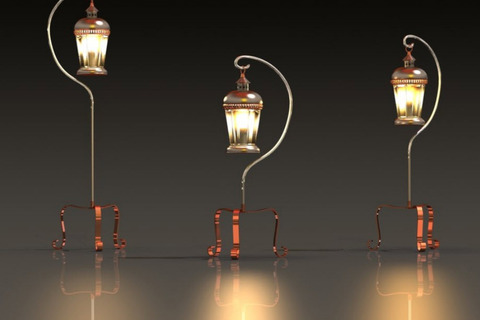

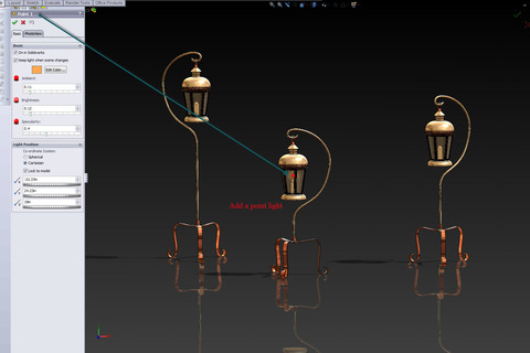

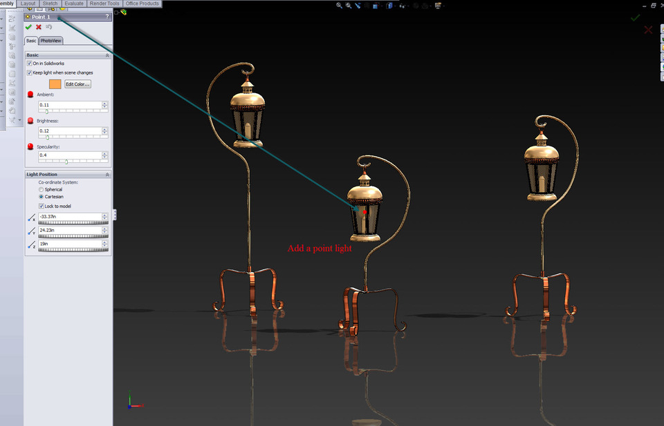

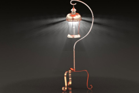

Christiaan - adding a point light in PhotoView will achieve this effect for you.
Answered with a tutorial: https://grabcad.com/tutorials/creating-light-source-for-lamp-lampshade

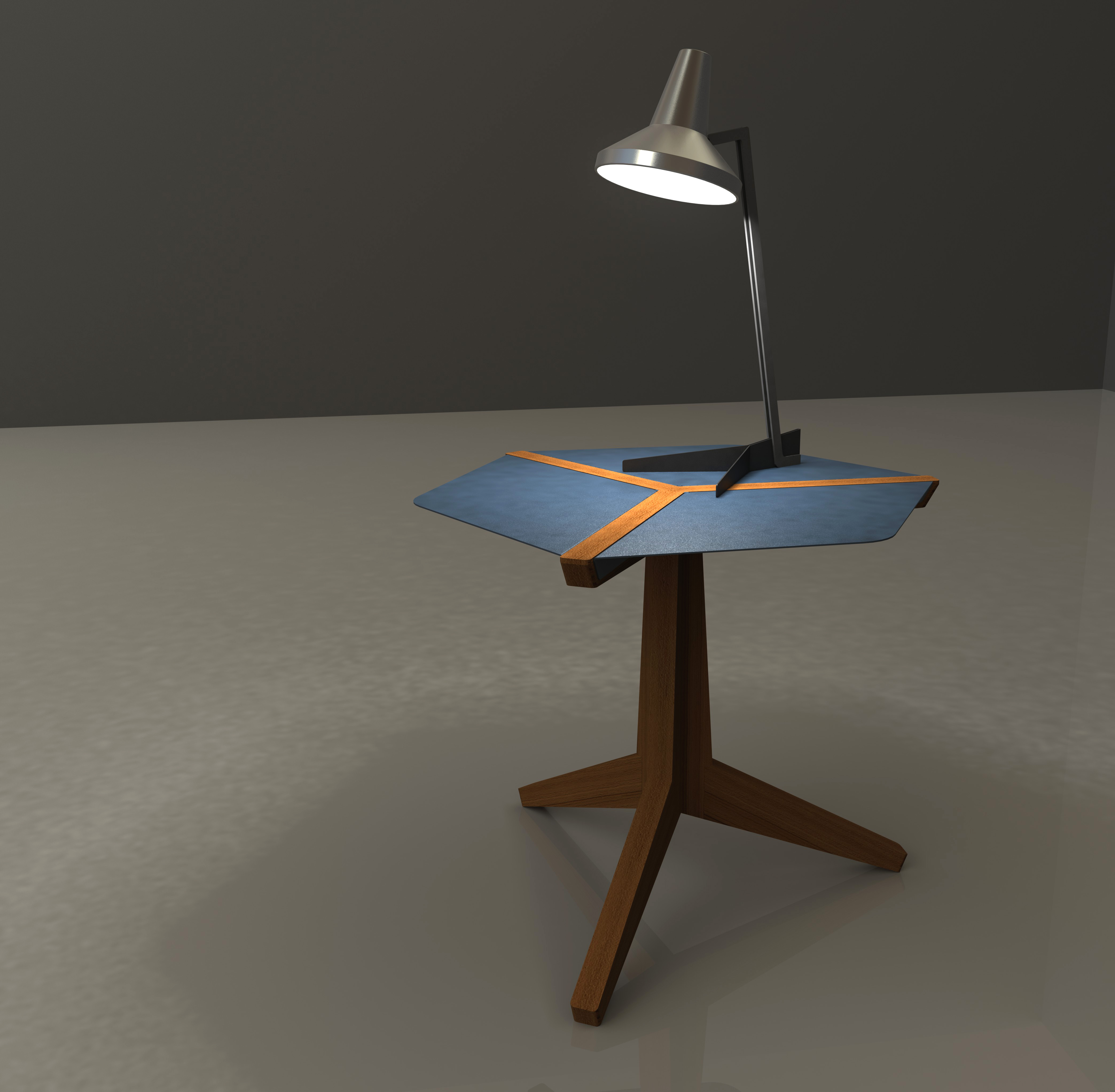

I played around a bit, this is what I got. all critics welcome.

Great quick tutorial! While I am familiar with light sources, I've never experimented with the Fog. Thanks for the design inspiration!
