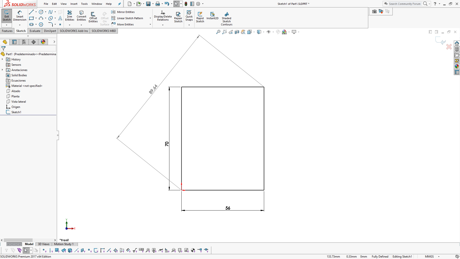

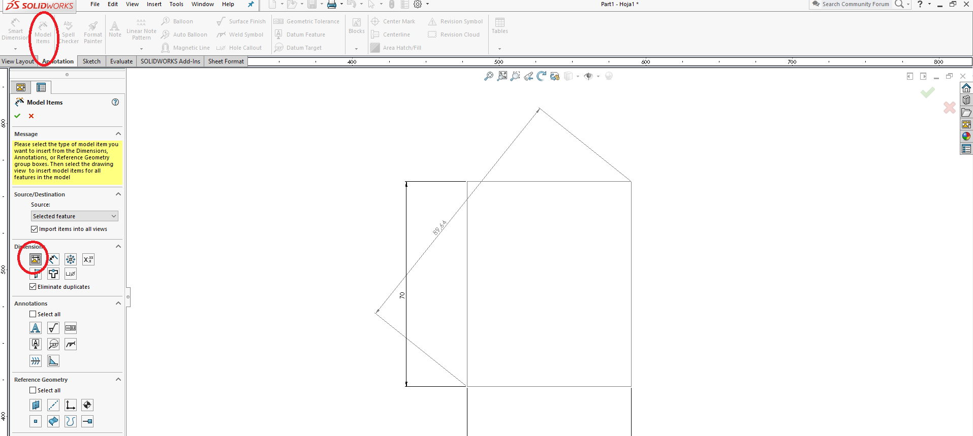

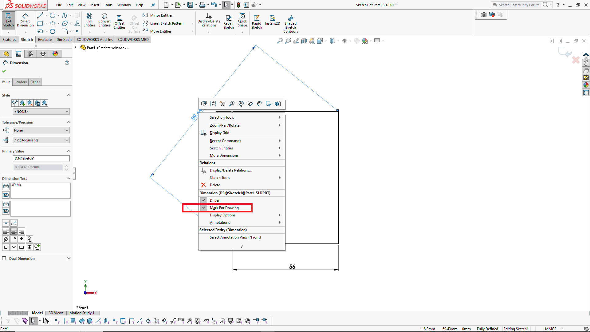

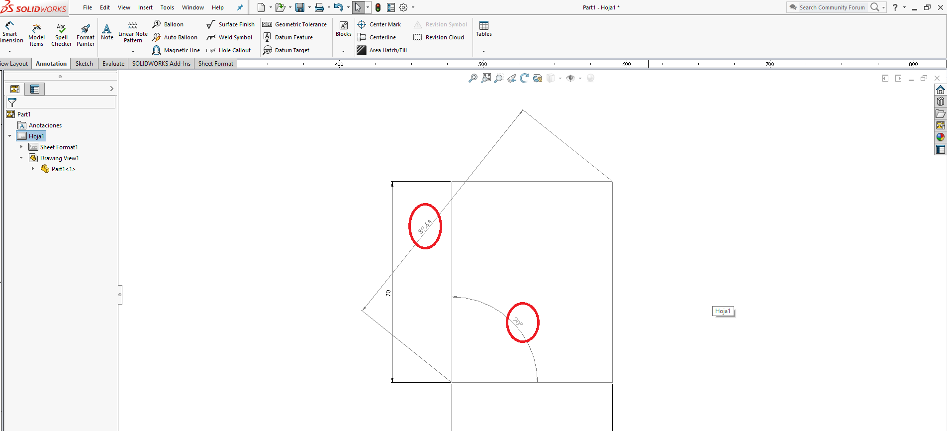

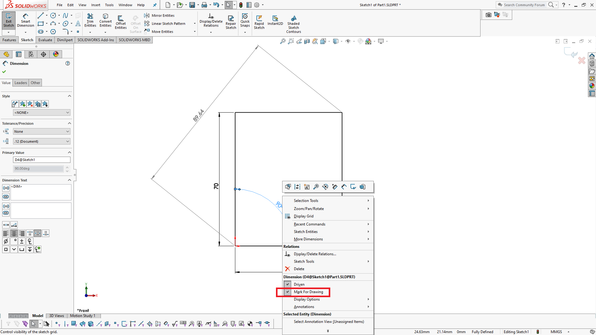

Dimension marked for drawing, How to import driven dimension into drawing in Solidworks? lololamoto 16 Mar, 2023 06:26 PM Helllo, we can automaticatly import dimension into drawing, but what about driven dimension? I can't find how to deal with this type of dimansion as they can't be marked for importation into drawing. Thanks Accepted answer Marcelo Valderrey Answered on 16 Mar, 2023 07:41 PM It is marked as any other dimension 1.png 2.png 3.png 4.png 5.png 0 Other answers
