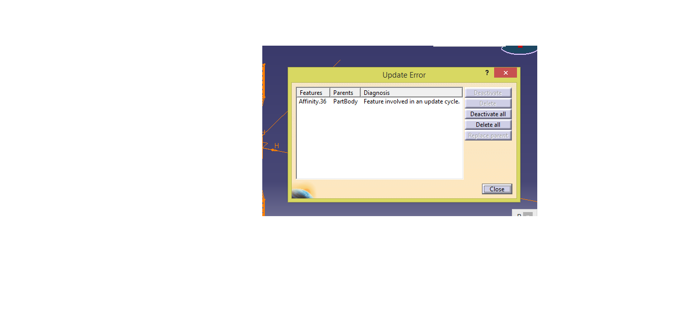

facing error while using affinity command in CATIA.
Hi guys, i am making some model. During designing i select the generetive shape design workbecnch, when I use affinity command to scale my object in y direction, i am facing the error. I atached the error picture as a image file

If you have a body which has been copied and pasted with link. And if this body added to main body with boolean operation commands. You may have created a loop. So you can get this error message. Can we see your specification tree and features?
If it is surface feature, you can get same problem due to parents/children relations.
