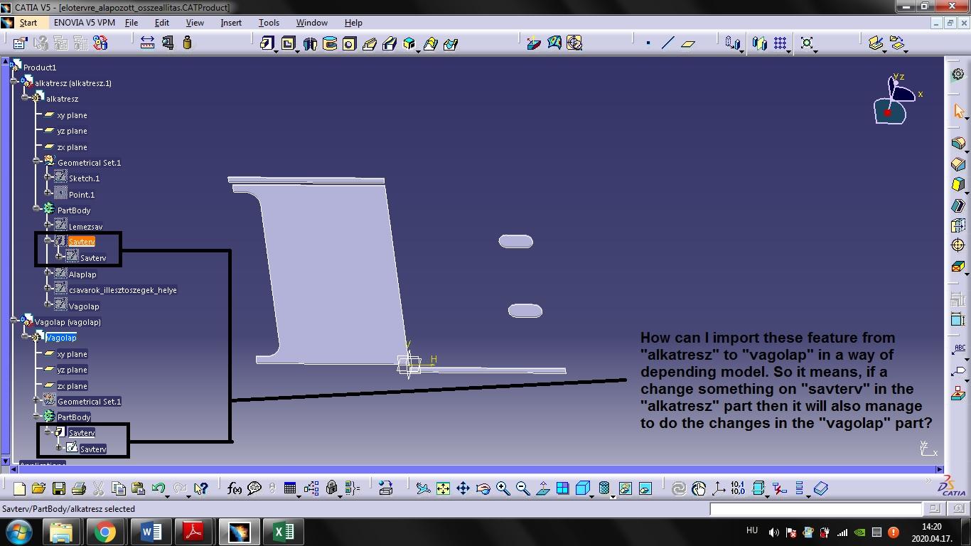

How can I import features (extrusion etc..) or sketches from one part to another with dependence?
Dear colleagues,
How can I import these feature (in the picture) from "alkatresz" to "vagolap" in a way of depending model. So it means, if a change something on "savterv" in the "alkatresz" part then it will also manage to do the changes in the "vagolap" part?
Thanks your efforts and answers in advance!
All the best for everyone
Accepted answer
As mentioned in the comments... Copy the element first from the ALKATRESZ, then use Paste Special and the option "As Result With Link" to duplicate the element in the VAGOLAP part.
