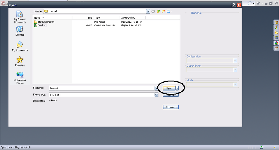

SolidWorks imports an STL file as either a Solid Body or a Graphical object. You cannot add features (Cut, extrude, etc...) to a graphics body. when opening an STL file and the STL extension is selected in the open window, click options* and select solid body.
The real question is how to convert an STL file to a modifiable Solid Works file.
The reason for this that has not been mentioned here is sometimes you already have an STL file that was created or downloaded by someone else that you want to modify to change a few things. I have often needed this for 3D printing. I have downloaded files from thingiverse and wanted to make some minor changes to the part.
The person here that said download FreeCad and save the file out as a Step file was on the right track but there is no need to do that. Here is the correct method that works.
1) Open the STL file in Solid Works as a solid body.
To do this select the file type as STL and click the options button and select "SOLID BODY" from the radio buttons in the middle of the dialog.
2) After you open the file select "Save AS" from the file menu. Change the "Save As" file type to "STEP AP214" and save the file.
3) Now open the step file and you will be able to select any surface to sketch on.
When you are done editing simply save the file as a Solid Works part file. I think this is what everyone is really looking for here.
