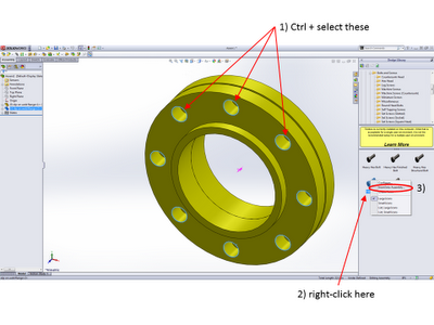

how to add an element from toolbox AZIZ AMTDI 8 Jul, 2015 07:26 PM how to add an element from toolbox ? 2 Answers Altug Tuncel Answered on 9 Jul, 2015 01:46 AM click right mouse button. Select from ToolBox. or as in the picture 1.png Altug Tuncel Answered on 9 Jul, 2015 01:50 AM For more information about setting up Toolbox, refer to the PDF titled “Toolbox_Setup”. Understanding_Toolbox.pdf
