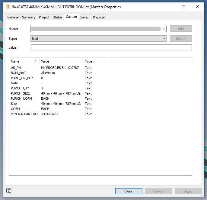

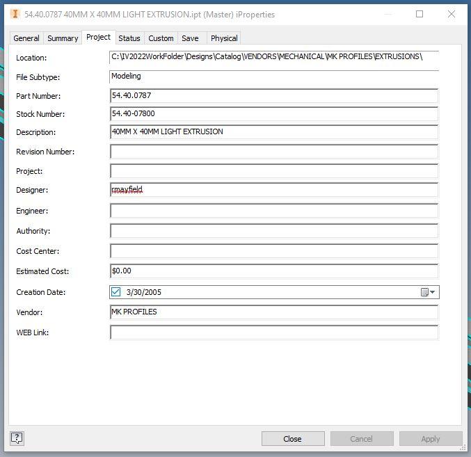

When using iProperties, always use existing Standard iProperties such as "Part Number", "Description", and "Vendor" whenever possible. Then create custom iProperties as needed. Custom iProperties should be added to your part (IPT) template files so they are consistently available for every part.
I've included a screenshot of the standard Project iProperties and another screenshot of the custom iProperties that I use. I have used this format for over 15 years. These may be a good starting point for you. I can explain these iProperties if you need more information.
As I mentioned in another comment, there isn't a method to map parameters to iProperties or vice-versa. In most cases you will need to manually enter the data into iProperties.
