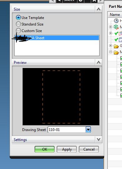

Just have a look , i think you might have edited the drawing or model templates, what you looking for is a sheet template to avoid a second .prt file opening.
also
If you choose drafting, do you see a choice menu like in the uploaded pics, If not please try to change the customer defaults like in the second picture of uploaded pics.
Then this is what i think the solution to your problem is:
Which PAX file/s did you edit?
There are three (native or managed is irrelevant).
ugs_model_templates.pax or nxdm_ugs_model_templates.pax is for the model templates (File -> New).
ugs_drawing_templates.pax or nxdm_ugs_drawing_templates.pax is for the drawing templates (File -> New).
ugs_sheet_templates or nxdm_ugs_sheet_templates.pax is for the sheet templates (Insert -> Sheet).
If it has nxdm_ in front, then it is used for managed mode, otherwise it's for native.
So to have your template appear in Start -> Drafting, you need to edit ugs_sheet_templates or nxdm_ugs_sheet_templates.pax
hope this helps.
