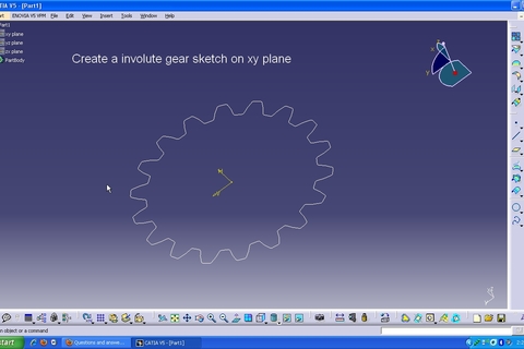

    1. Step 1
      Sketch an involute gear on xy plane

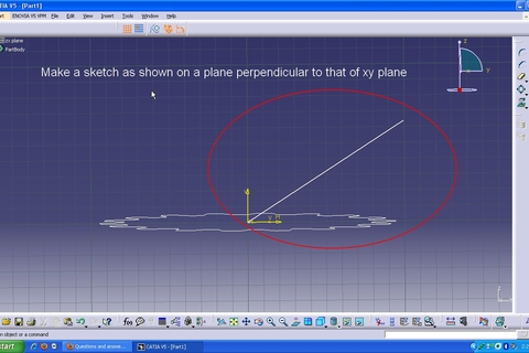

    2. Step 2
      Sketch an inclined line on a plane perpendicular to xy plane
      Medium

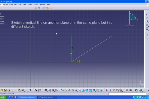

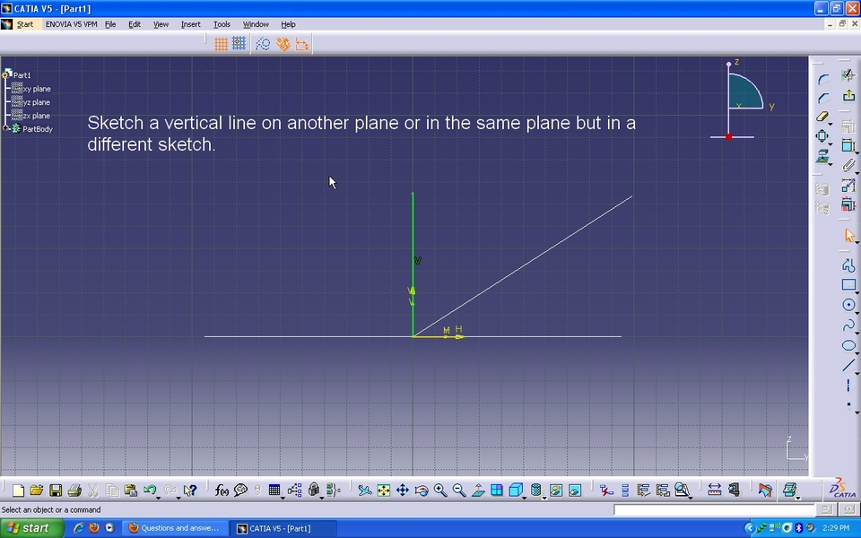

    3. Step 3
      Sketch a vertical line may be in the same plane but in a different sketch
      Medium

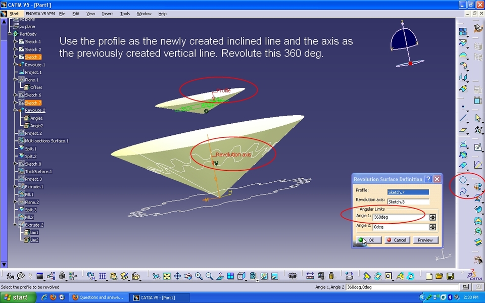

    4. Step 4
      Revolute the line drawn earlier using the vertical line as axis.
      Medium

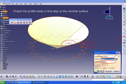

    5. Step 5
      Project the profile made in first step on the revolute surface.

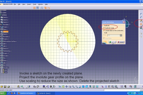

    6. Step 6

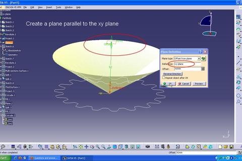

      Create a plane parallel to the xy plane
      Medium
    7. Step 7
      Invoke a sketch on the newly created plane
      Medium

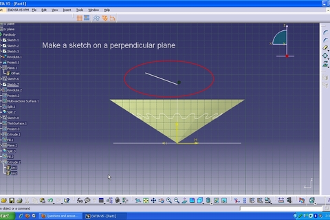

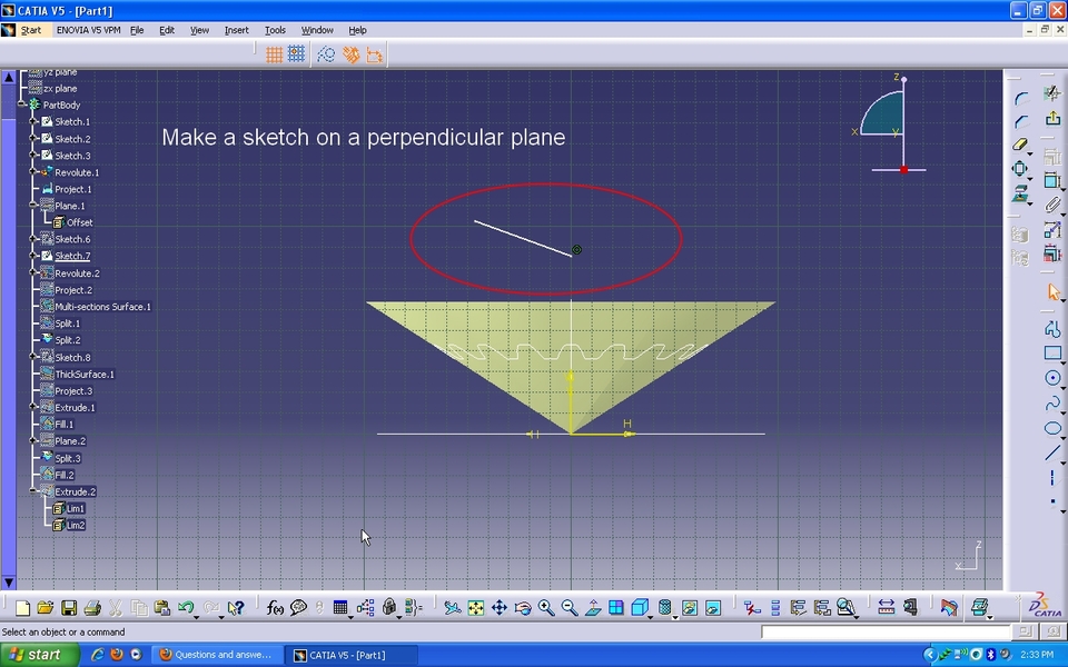

    8. Step 8
      Make a sketch on a perpendicular plane
      Medium
    9. Step 9
      Create another revolute surface
      Medium

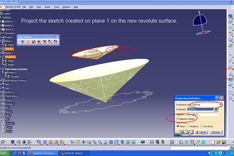

    10. Step 10
      Project the sketch made on plane1 on to the revolute surface.
      Medium

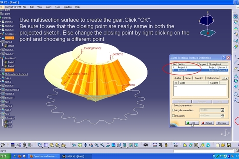

    11. Step 11
      Use multisection surface
      Medium

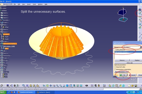

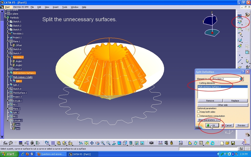

    12. Step 12
      Split out the unnecessary parts.
