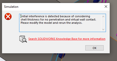

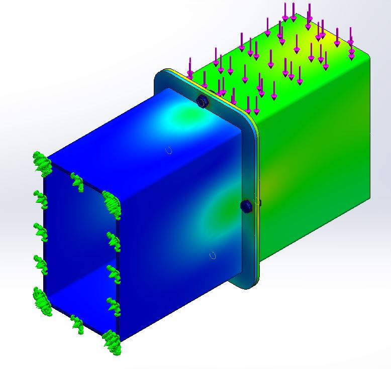

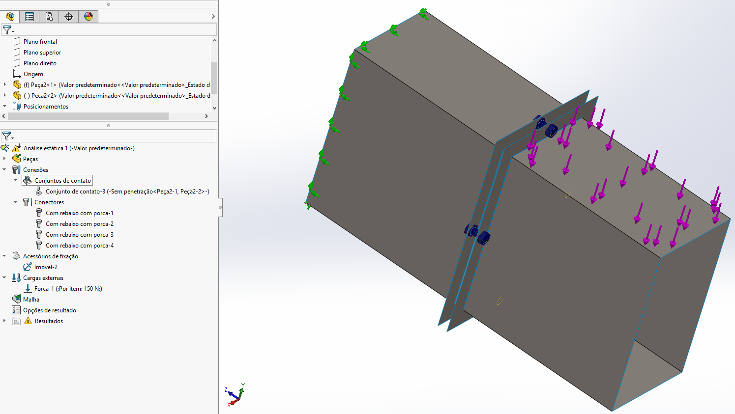

I've made two shell parts, distanced them accounting for their width, fixed them and added bolts. The contact planes for the bolts are ok. But I keep getting this error. Does anyone have any idea on how to solve this? I can't find anything on Google.
I've used no penetration and fixed an edge and the mesh generates ok!

Are you working with surfaces?
Like this.
