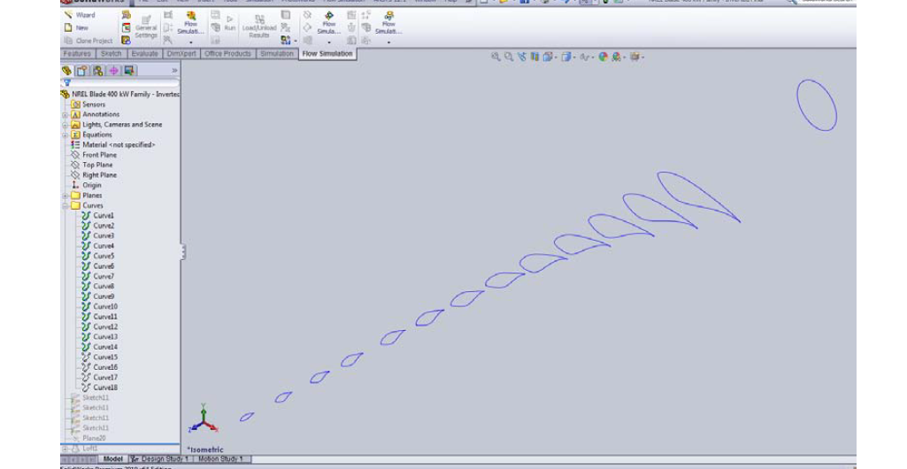

I designed the wind turbine blade in Qblade software chord lengths and twist angles, and generated the blade as sections and each section is defined by x y z in .dat file
I'm supposed to put a curve in each plane in solidworks

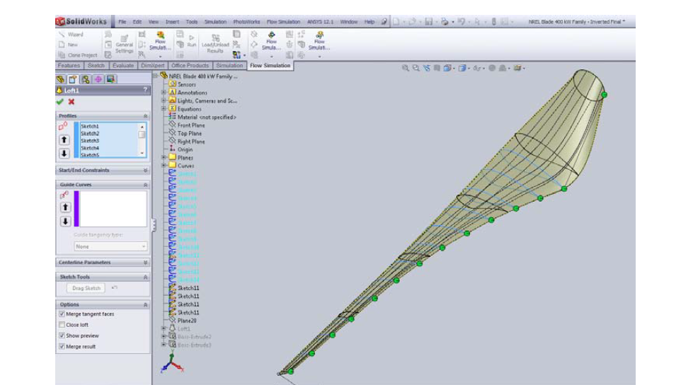

each plane represent a section of the blade and each section represent an airfoil then loft command to extrude the sections to form the blade
when I import the X Y Z.dat file in solidworks as a curve ,Is it imported with its twist angle ? or the curve is created without angle ?
if without the twist angle ,how to define the twist angle for each section ?
The felix command twist along the blade not for each section or plane ,
