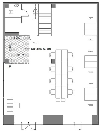

Floor area dimensions where the meeting room should fit are 3000x3400mm. See also the floor plan drawing

Some more measurements:
The doors at the south are 1.80m wide, so anything narrower can be transported in from there. The height of the door is 2.78m.
The height of the room is 3.60m, but the lamps, ventilation pipes etc are a bit lower, so 2.90m is the actual height under which the meeting room should fit.
Kristina Narusk almost 14 years ago
Neil, the room can have its own floor but it's not mandatory. E.g there can be designs that have lifted floors (see the photo example at the top of the challenge page), but designs with walls only are also fine.
The office floor is concrete, floor heating underneath, so drilling the floor in order to attach the walls is something that should be avoided.
