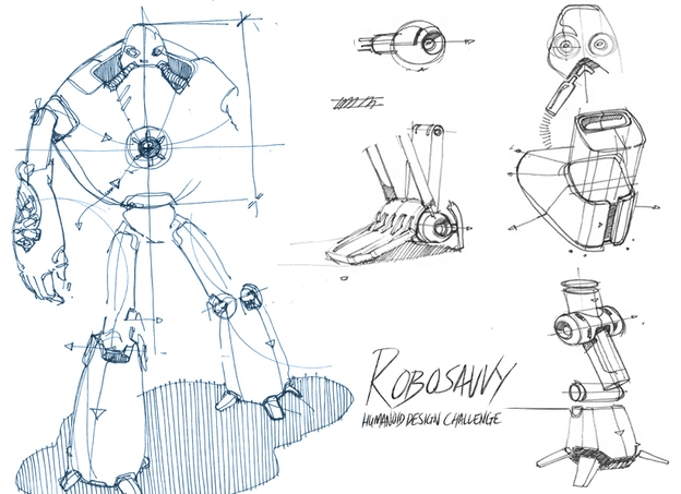

Robosavvy is looking for your help in gathering fresh ideas for the design of a new humanoid robot designated for entertainment and education. Our objective is to launch a new open-source humanoid robot that will look great and will be agile and smart at a reasonable cost.
Comparable education and research humanoid robots cost over $10,000 due to their plastic molded shell parts, expensive actuators and closed-source business approach. We want this to be an open-source robot that will outperform its rival platforms while keeping the cost of materials to about $1,000. We will achieve this by utilizing materials and fabrication methods available to anyone. Materials include aluminum sheet and 3D printed parts for structure, vacuum formed polycarb exterior shell, servos for actuation and low cost electronics including Raspberry Pi for brains.
We expect to have to do some modifications to the chosen design to make the robot perform the featured range of motions because we realize the designer may not have all the practical experience designing humanoid robots. We will adapt the shell if needed for polycarb vacuum forming. We will also handle the electronics involved in power management and servo control, in addition to developing the core open-source software to make the robot move, including ROS support, simple python scripts and physics simulation.
You must include IGES or STEP files and at least one rendering. Native CAD formats are optional but encouraged.
