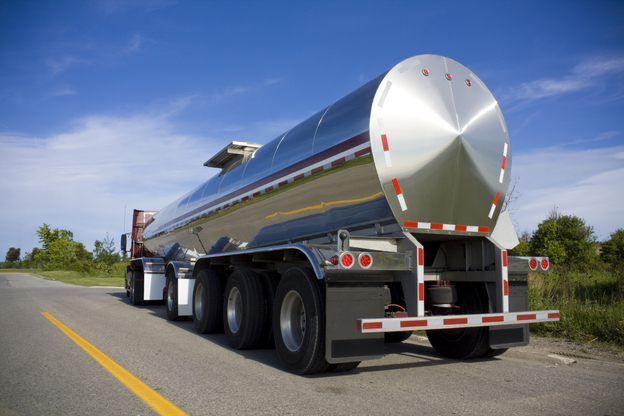

What is an underrun
Underrun protection devices at the rear end of trucks help to increase traffic safety significantly. To enhance the safety of passengers during a car accident involving a passenger vehicle and a large truck, trucks are required by law to have an underrun protection system at their rear end. This device keeps colliding cars from running under the truck which would have disastrous consequences for passengers within the car. The underrun protection needs to be stiff to ensure its performance during a crash while being as light as possible for fuel efficiency reasons. Last but not least, it should be aesthetic to make the truck look as cool as possible.
About this Challenge
The challenge is to come up with a new design for an underrun protection that is light, stiff and aesthetic. Both law as well as the installation situation pose some specific design requirements that have to be met. All the design requirements are described in more detail in the text and drawing below.

  • benzaoui
    benzaoui over 11 years ago
    Can you tell me the place to use this design
    or the mechanism to Linking Design
    I want pictures

  • David Heiny
    David Heiny over 11 years ago
    Benzaoui, the challenge image at the top of this page shows a (slightly different kind of a) truck underrun protection. The one that shall be designed in this challenge will be connected via bolted connections to the frame of the truck.
    David Heiny has uploaded 1 CAD models & has left 26 comments.

  • benzaoui
    Mr - David Heiny- I'm talking about the background image of the trailer where you want to put this Design
    benzaoui has uploaded 15 CAD models & has left 43 comments.

  • David Heiny
    benzaoui, I will try to provide such an image. The underrun protection device will be connected to the frame of the truck at the inner side of the fixation holes. This is why the 1060mm is important (that's the width of the truck frame). That's also the reason why the inner edges of the fixation holes are marked red in the technical drawing.
