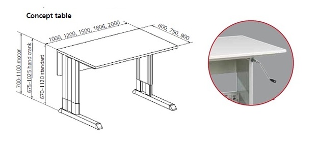

Requirements
  • Method to adjust manually height of the table top
  • Maximum moved weight is 500kg
  • Height adjustment from 650mm to 1050mm
  • Table top has to move on straight position
  • Mechanism has to work without external energy supply (electricity, pressure air, hydraulic etc.)
  • Energy storages can be used to reduce the needed hand power
  • Adjust speed with reasonable power has to be app. 15mm/s
  • It would be good if move (positioning) of the table is stepless or steps are as small as possible
  • Relatively weak person has to be able to use the solution
  • Adjust work has to be easy to carry out
  • New solution must be simple, convenient, producible, reliable, strong and durable
  • Target for the production cost of whole table frame should be under 350USD
  • Solution should follow Sovella design style in general level
  • Design must meet the dimensions shown on the picture
  • Frame of the table is steel, but we are open for other materials also. The table top is made from wood material

  • Erkki Kiviniemi
    Erkki Kiviniemi almost 14 years ago
    Thank you for the comments. Some answers:
    - 100mm is not enough for height change, it should be app. 400mm (650mm to 1050mm)
    - Table top is completely horizontal, but if you have a solution, which give also possibility to change angle of the table top; by all means.
    - Mechanism has to work without external energy supply (electricity, pressure air, hydraulic etc.)
    - Frame of the table is steel, but we are open for other materials also. The table top is made from wood material.
    - Yes; 500kg is quite heavy to lift manually with speed 15mm/s. Indeed it needs 75W and it is too much, if a person has to produce the power “on line”. But perhaps there are possibilities to use a stored energy… Anyway, we are open for all ideas, even you think that your idea do not work with 500kg.

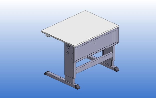

  • Erkki Kiviniemi
    Thank you for the good questions and comments. Here answers:
    - STEP –models are soon available
    - Target for the production cost of whole table frame should be under 350USD. Due to the competitive situation production cost is quite sensitive matter and ideas, which decrease production cost are welcome.
    - It would be good if move (positioning) of the table is stepless or steps are as small as possible.
    - At the moment we have motorized table and hand-crank table. In the motorized table are used Linak’s actuators and control boxes. In the hand-crank tables are used our own mechanism, which base on gear wheels and screws.
    - Positioning accuracy between left and right leg of the table is important, because table top mast be all a time as straight as possible.
    Erkki Kiviniemi has uploaded 0 CAD models & has left 13 comments.
  • Erkki Kiviniemi
    Unfortunately we have not good 3D –models from components of the table, because original design is relative old and it has been designed in 2D. We have only “principal” 3D -models. From those models I took couple pictures, which hopefully helps.
    I highlight that new solution is not needed to put into existing table structure. Because almost all big components of the frame are made from steel sheet, they are relatively easy to modify according to needs. It is enough if you just follow Sovella design style in general level. Fortunately our design style is not "thin"; relatively fat bars are used.

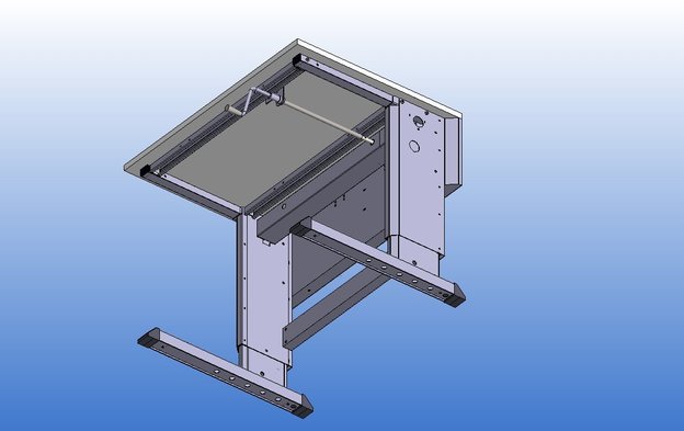

  • Erkki Kiviniemi
    Main points from this comment chain have been added to the requirements list, so you do not need read through whole chain.
    Operate principle of our current hand-crank table:
    Hand-crank shaft is connected to the bevel gear, which drives width direction shaft, which is connected to the bevel gears in both legs. Bevel gears of legs drive screws, which move the table top.
    It is possible to use our existing components, but I feel it is better that you do not stuck on them. Finally we have to anyway finish your models for our production and in this stage we can use our existing components if it is reasonable. So, be free with your ideas.
    I am sorry, but exact production costs of current products are trade secrets. Anyway, do not hesitate to give proposal even you think that cost is bit too much; the idea can be commercially good after small modification.
    It is target that a mechanism is able to scale all table sizes. Table size 1000mm x 600mm is not so important, but it is positive thing if the idea is able to scale to this size also.

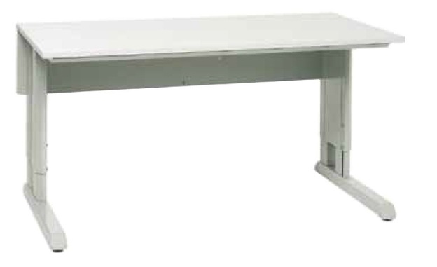

    For anyone to use in the challenge.
    Posted a SW file that is configurable for all the sizes of workbenches, also several of the sizes in step files
    Sovella Existing Workbench (15 sizes)
    Sovella, existing workbench
    Chris Duncan has uploaded 20 CAD models & has left 142 comments.
