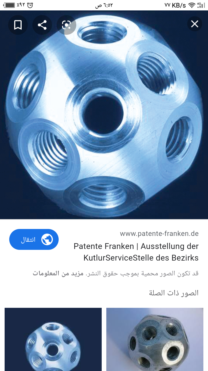

Hi,
I want to process steel nodes 60-300mm, cnc turning
Complete stock to finished part of that range of sizes could be done in a machine similar to the Okuma Multus, Mazak Integrex, etc.. or you can do this part on a 5-axis mill with a suitable C axis. Something like the DMG DMU50, Hermle C42-MT, etc..
