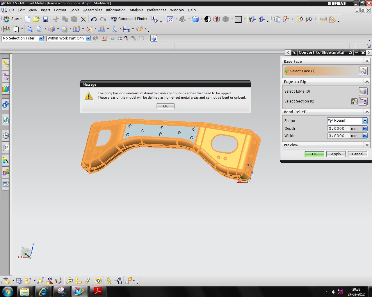

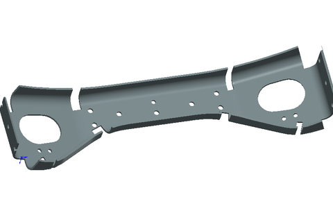

this isa simple crossmember ,herein drafting we have show the developed view ,but i am unable

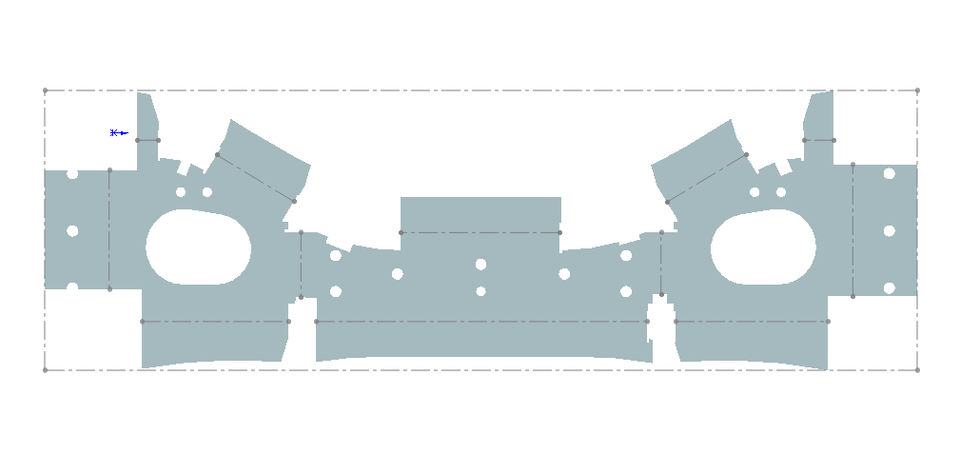

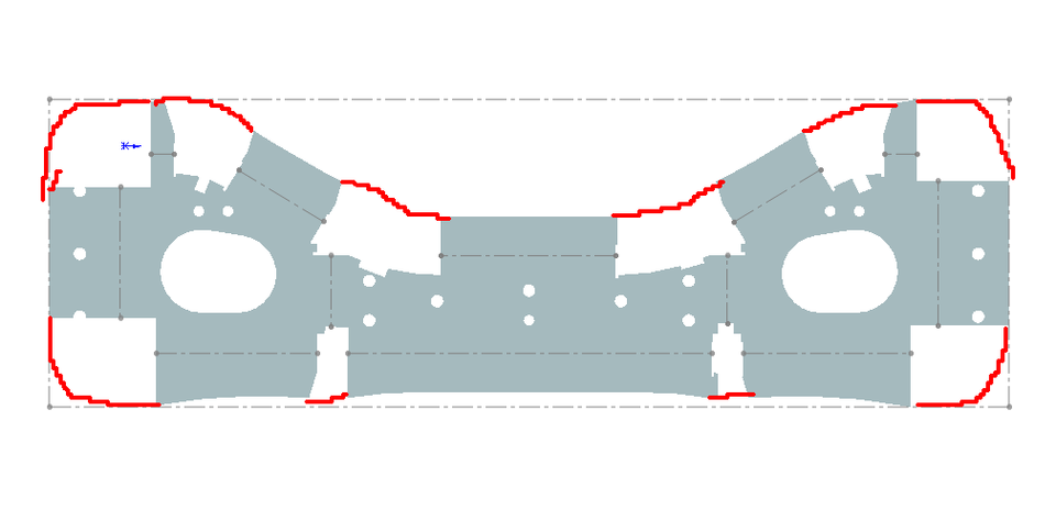

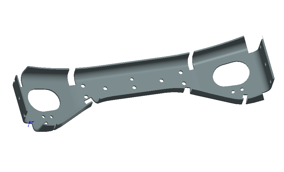

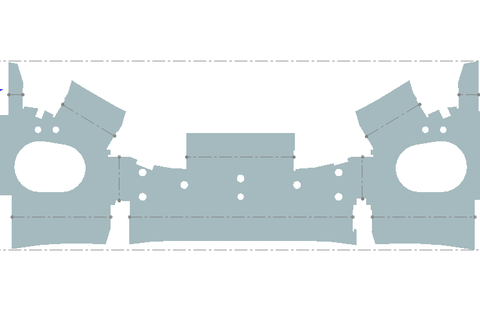

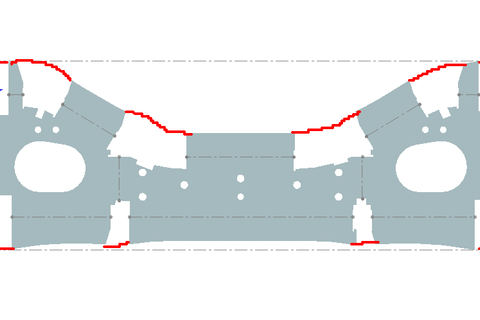

    I quickly did this in SolidWorks but NX should be similar. The problem with cad software’s figuring flat patterns is that they cannot calculate deep draw type forming, only linier bends (using k-factors). So remove the curves then fill them in after on the flat pattern. Really it an educated guess and you will have to adjust this flat pattern for your real world application.
    1. Step 1
      rip the corners
      Medium
    2. Step 2
      flatten
      Medium
    3. Step 3
      Educated guess to complete corners

  • NITIN
    NITIN about 1 year ago
    thanks chris but its not working in UG Nx iit show the error like this
    Added images

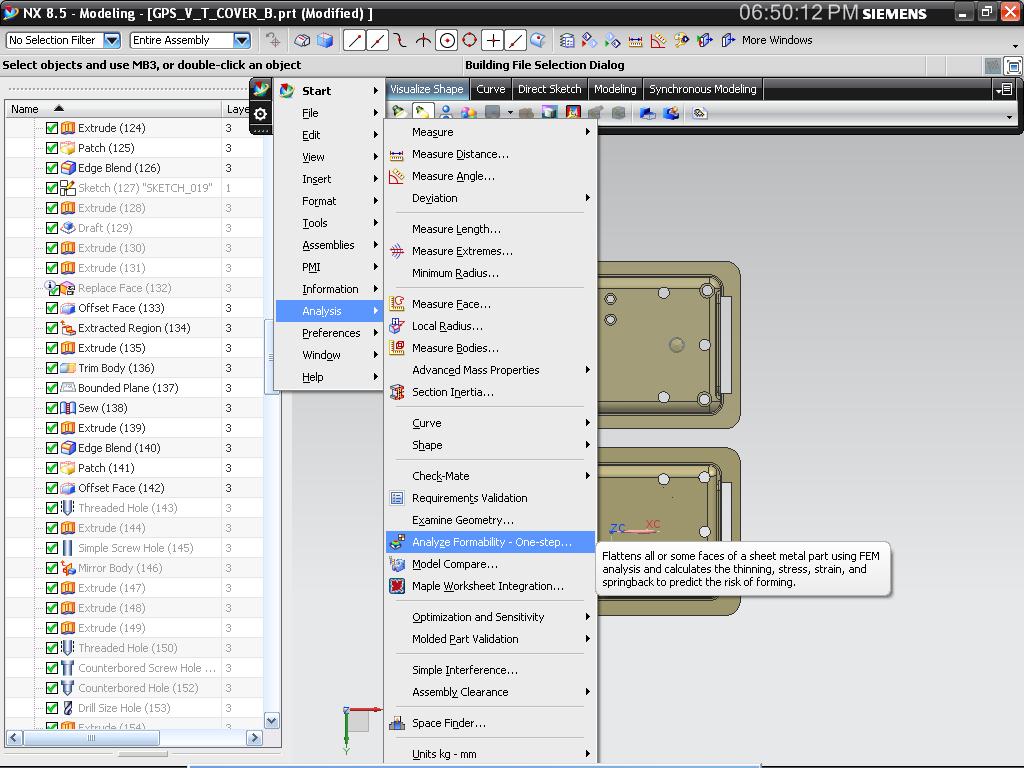

    Hi, if the part is an emboss part and you have one step license you can unform it like I show you in the attached images.
    Regards
    Frank.
