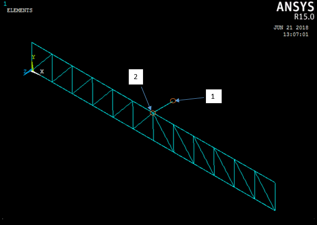

2. If I want NODE1 that is support move to direction UY. It have distance equal NODE2 when Loadstep running every STEP on LARGE Displacement Analysis. How I can do and what I need to using command ?
attach a file name : photo1

Make sure the degrees of freedom. Also check the displacement constrains. Constrain the translational or rotation for z axis properly.
