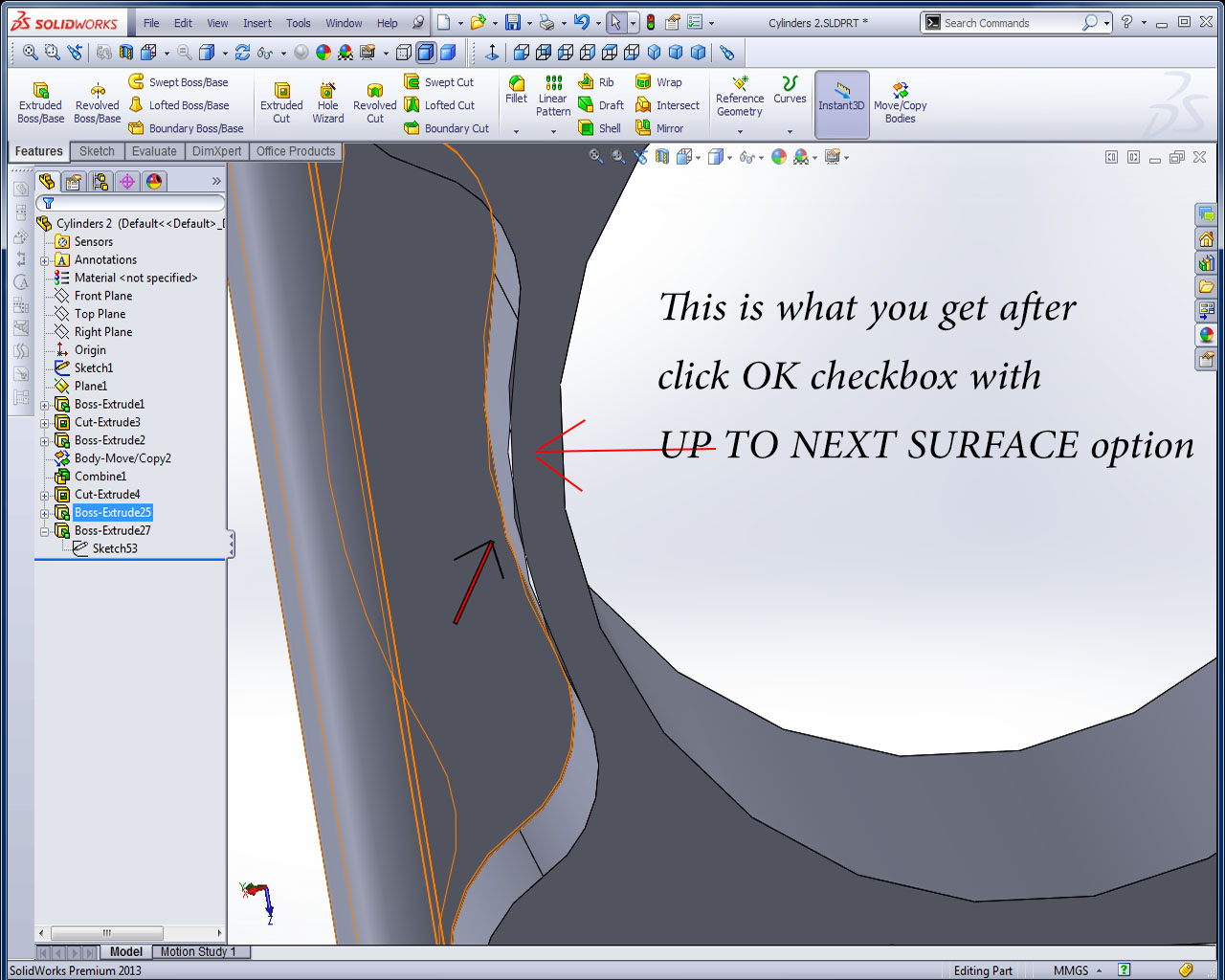

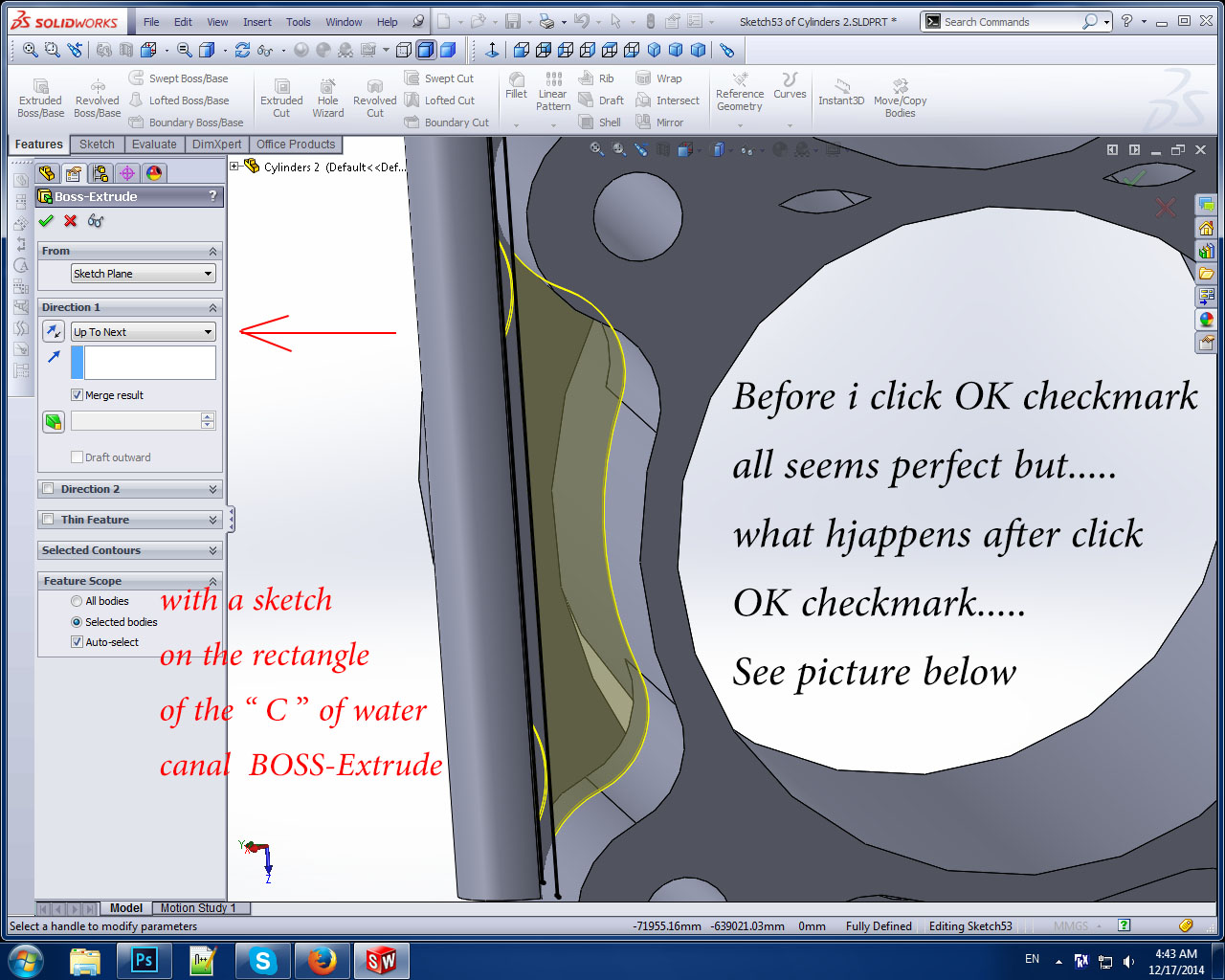

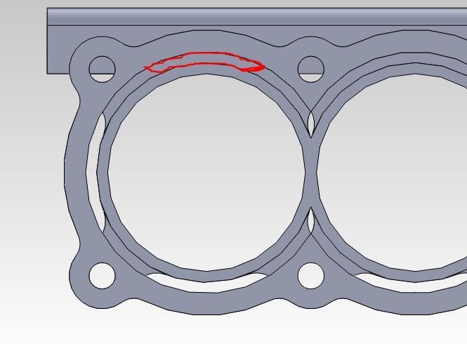

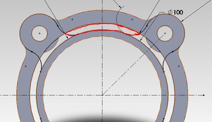

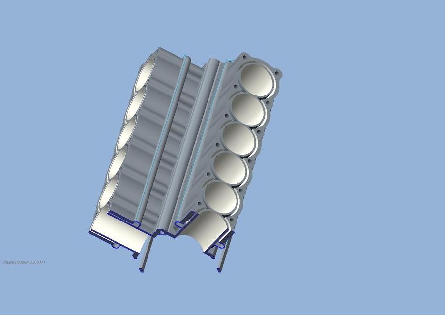

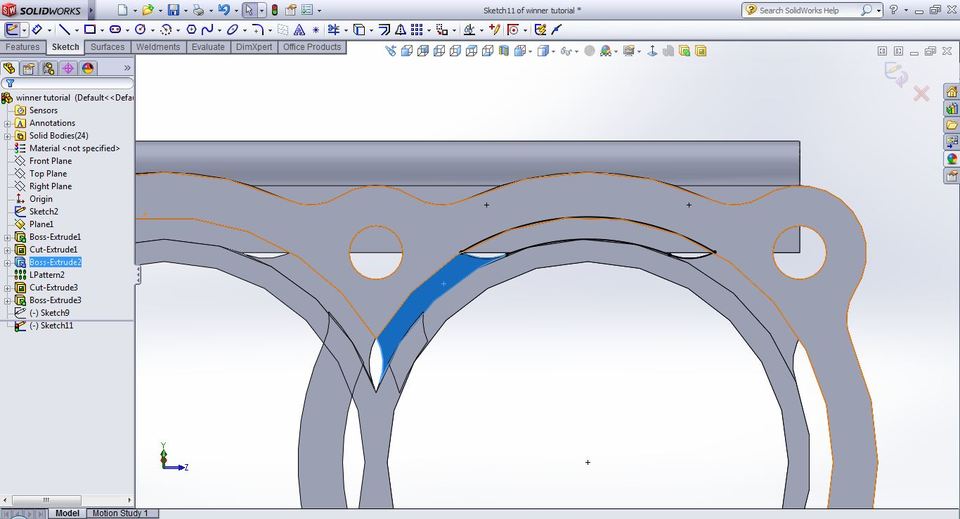

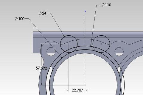

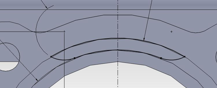

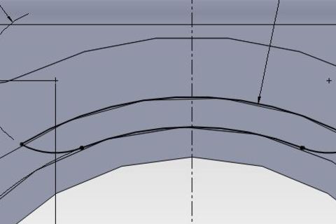

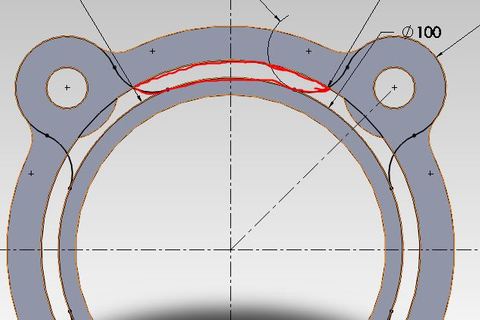

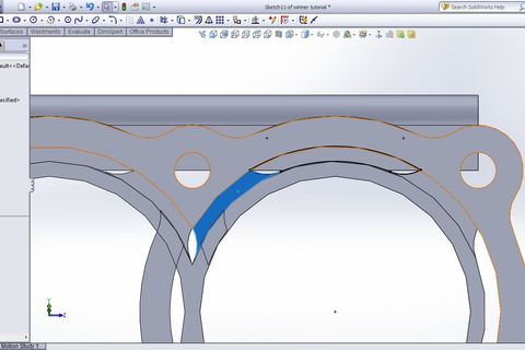

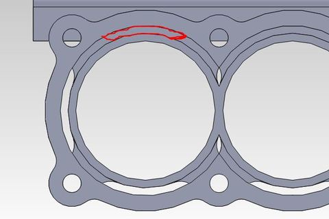

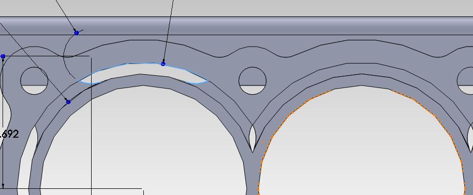

For kandarp, here is the picture of the cylinder cuts for the sleeve. What I've done is to go back to before the water sleeve is added and redrawn the 100 and 110 mm circles. That is the profile that we need to extrude after the water canal has been added.
Answered with a tutorial: https://grabcad.com/tutorials/tutorial-how-to-make-engine-part-11--2

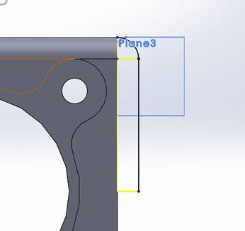

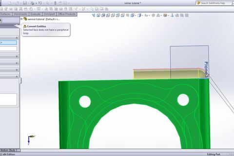

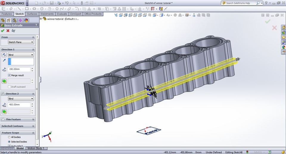

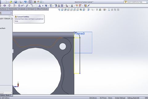

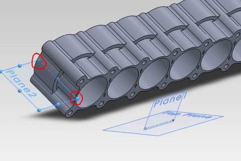

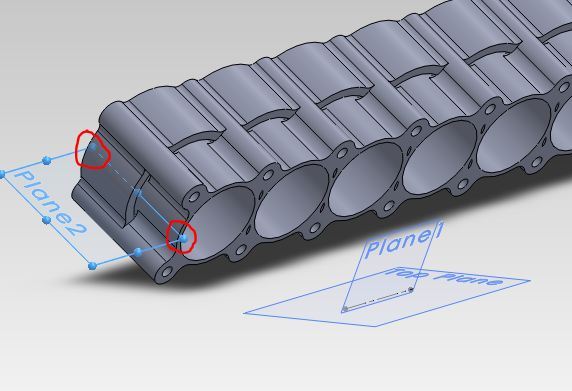

Here is how I made the 3rd plane.
Answered with a tutorial: https://grabcad.com/tutorials/tutorial-how-to-make-engine-part-11--1

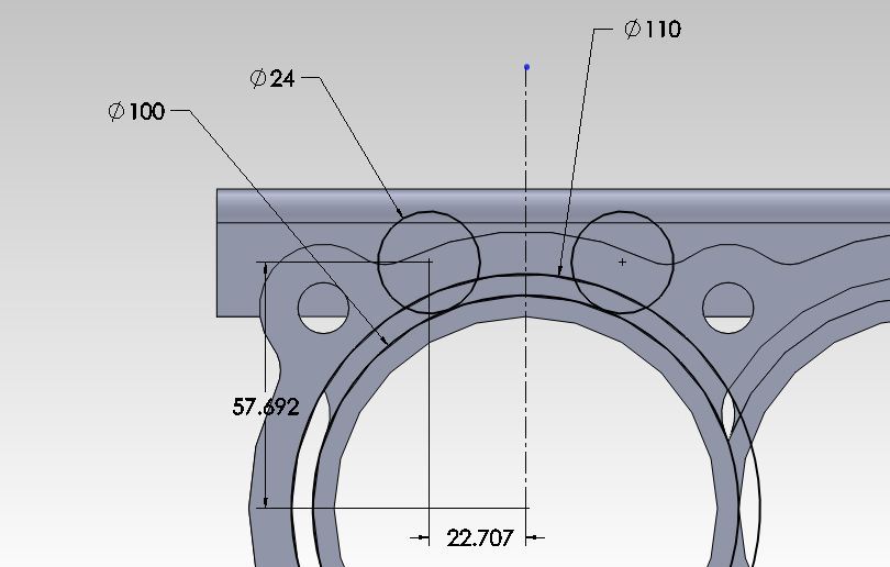

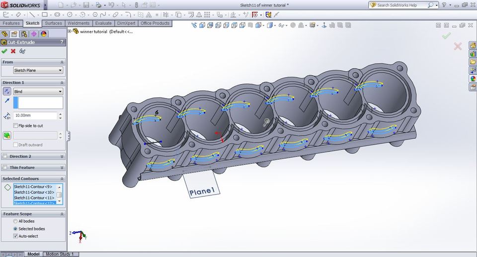

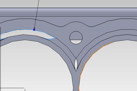

Here is what I've come up with for the cylinder cuts, around the sleeves. I've also noticed that the water jacket is incomplete, for it to be accurate, there would need to be in inlet, as well as outlet for each water tube. Hopefully you'll be able to open the drawing, or else I'll have to figure out how to post pictures here.

To be honest, step 4 and 5 are not very well explaned what you did. even while someone else explaned to make 4 cylinders and trim it.... but i found out how..
other then that.
What about the bolt holes, they need a cut aswell. Try to put a bolt in it, it will het stuck halfway.... Look photo of Step 4. On Step 9 the holes are okay.

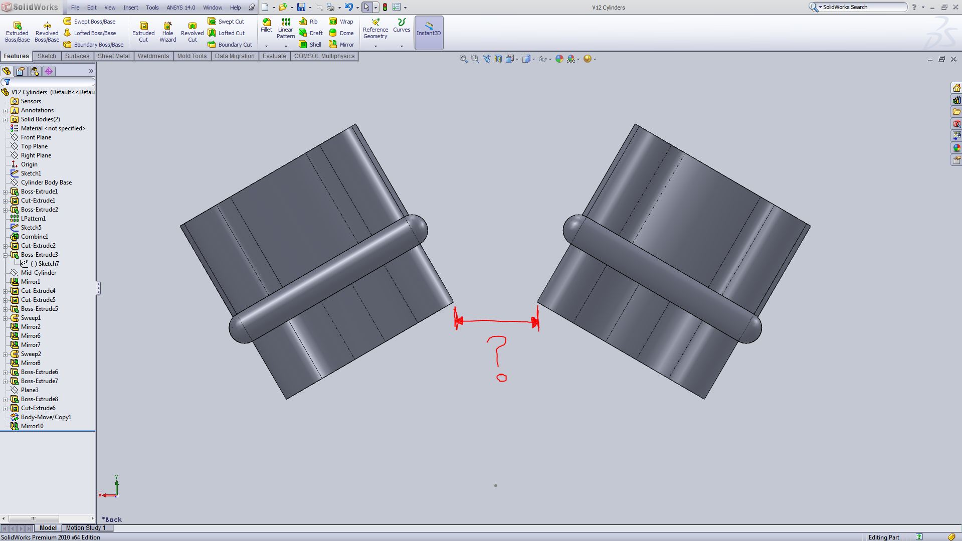

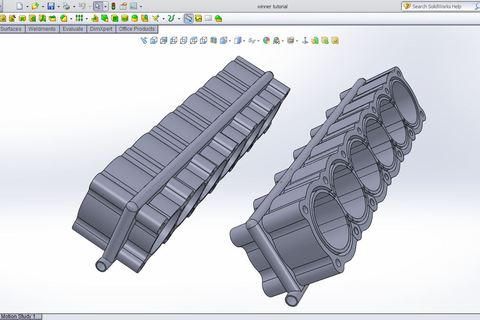

Hey,

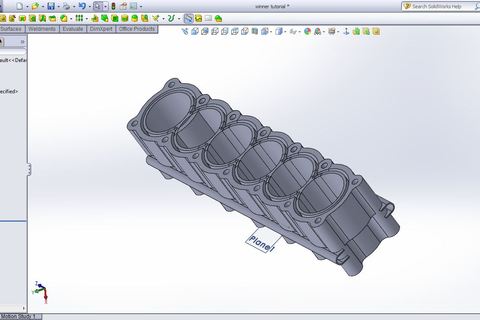

I need to know how far exactly is the 2 cylinder blocks are from each other.. When I started drafting them, I think my dimensions were wrong so I had to move them to an approximate distance. Can you take a look at the picture I posted to let me know what that dimension is?
Thanks,
Cullen

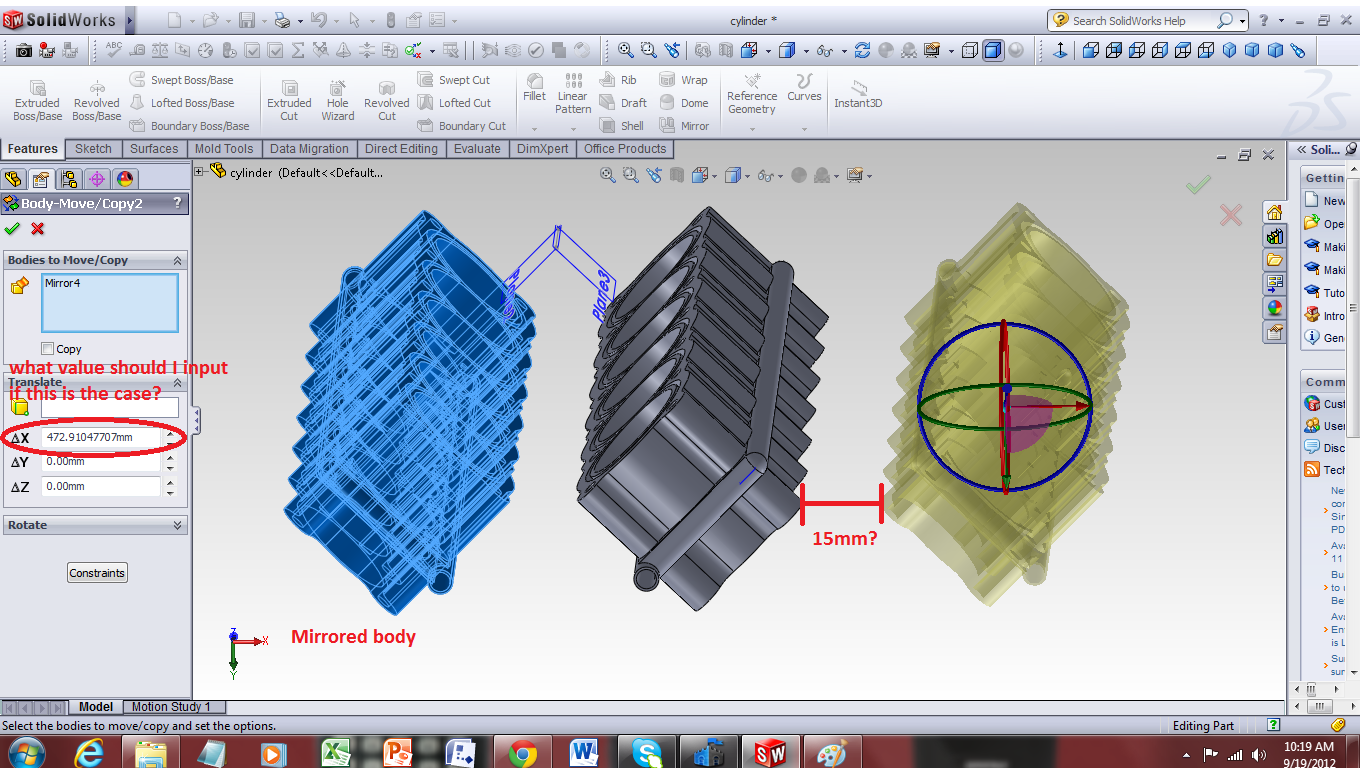

I think I'm in the same page with Cullen. I don't know how far these cylinders should be apart from eachother. Also I dont know if the method I used is correct. mirror the original body and use move/copy command. Need your help buddies. thank you

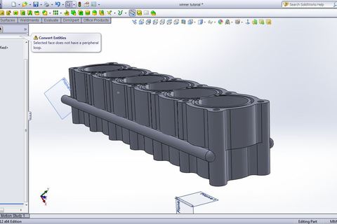

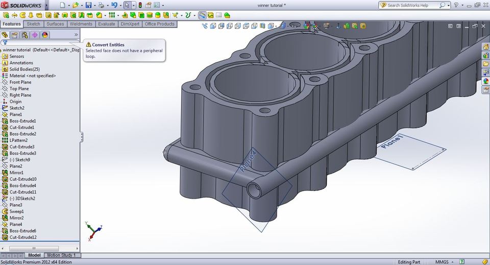

In step 5, once you make these extruded cuts the coolant would then spray out the top and bottom of every cylinder. is this correct or??
Also, not that its a big deal but you never show cleaning out the bolt holes because of the interferece from the water channels being added to the cylinders. Just a thought to help make it a more comprehensive tutorial for beginners like myself.

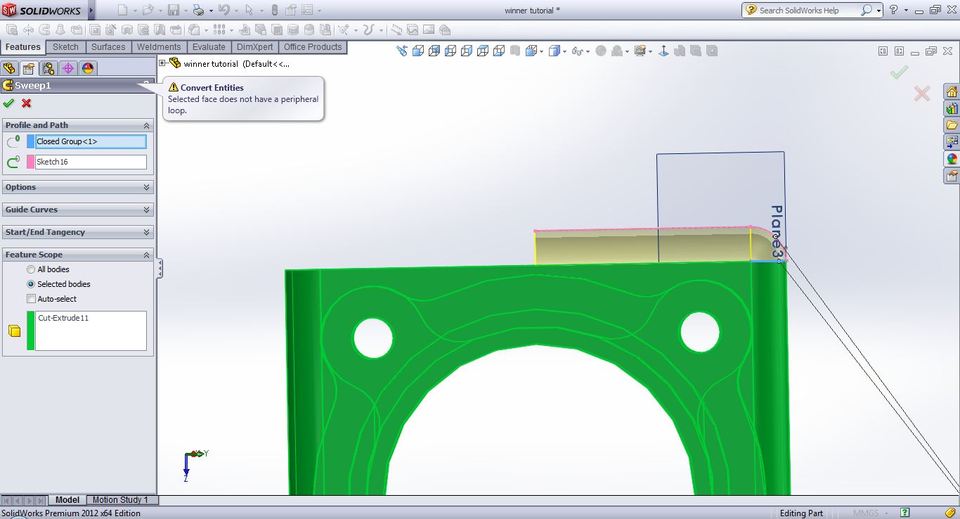

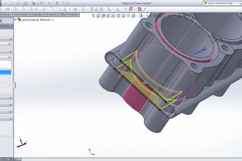

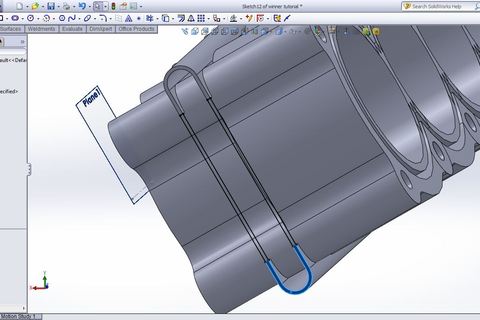

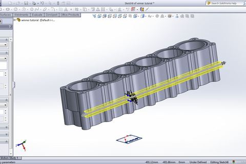

One more thing; the yellow lines in step 9 are distracting to say the least, i wasnt picking up on the fact that these lines are just part of the actual preview process and not lines that are needed to make the sweep. Really making my brain work today!! Thanks again!!

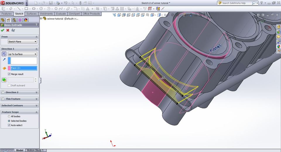

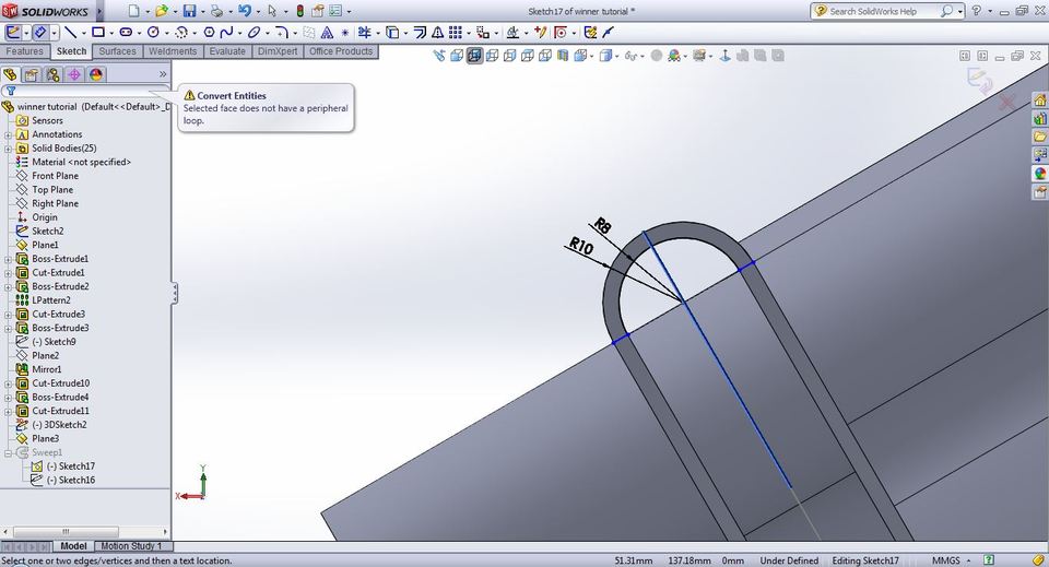

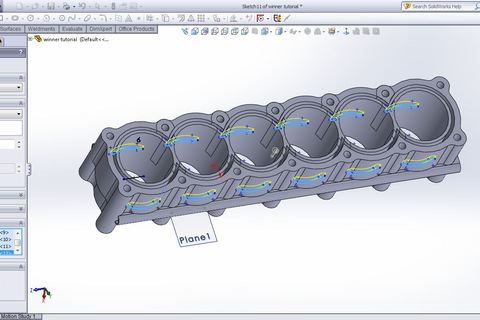

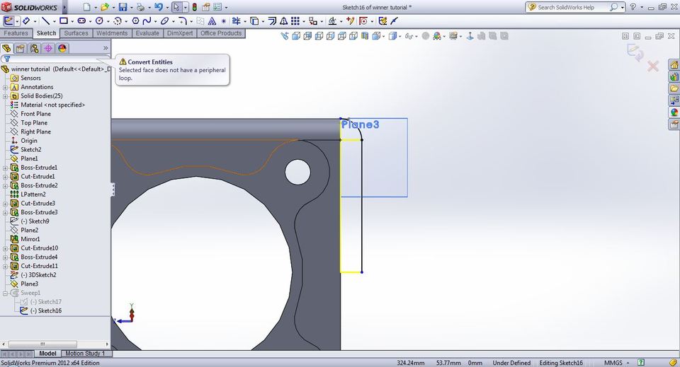

Venus,

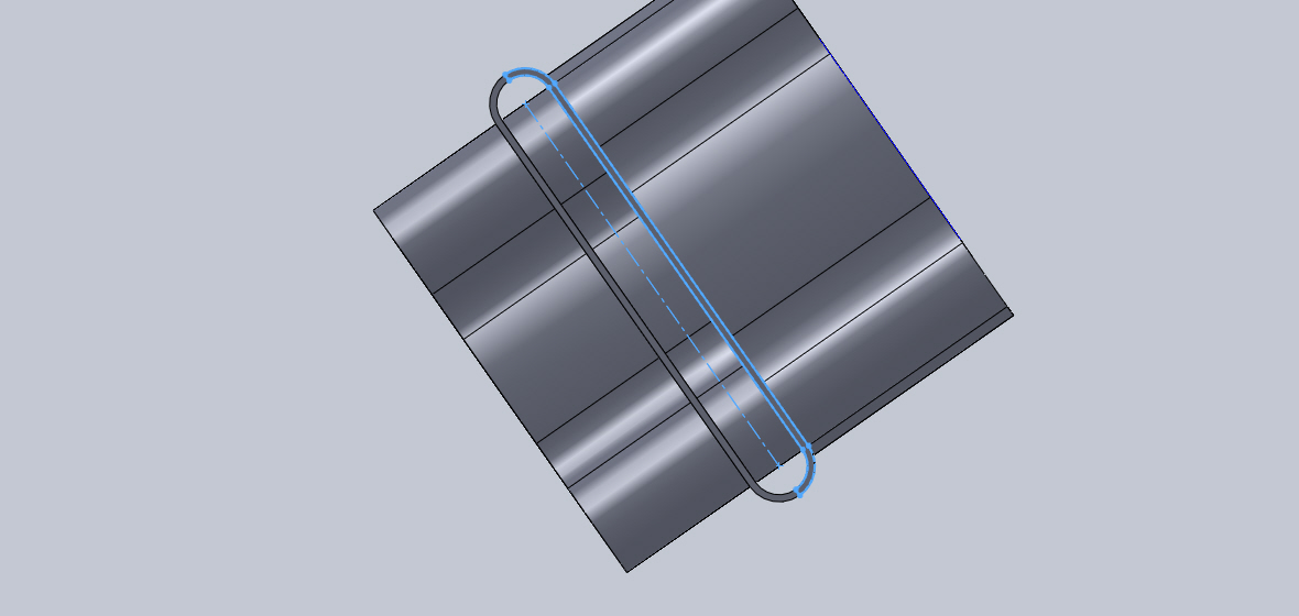

I am attaching a picture from the above exercise. All you need for this sweep are the two black lines you see in the picture I have attached. So you will need the quarter round and the straight line, then try to sweep the feature.
The "yellow lines" are confusing to say the least. They are just showing a preview of what will be done once the sweep is created.
If this doesnt help I will revisit the exercise and give you better instructions!!
Good Luck!!

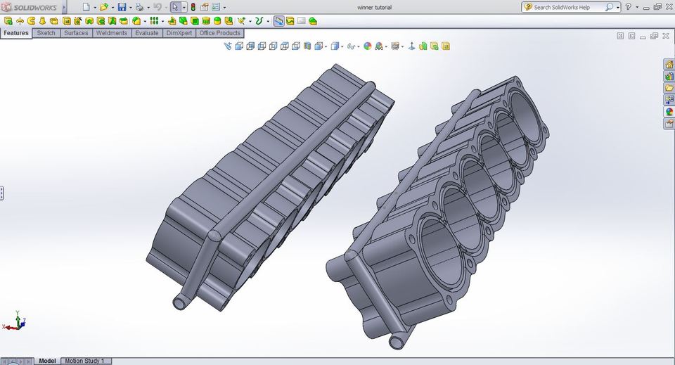

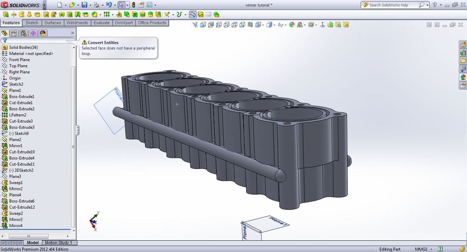

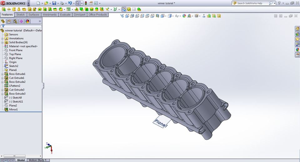

ı cannot use mirror feature. what can ı do to use mirror properly
mirror yapacağım zaman hata veriyor bana söylediği şu gövdeler kopuk olduğu için mirror yapılmıyor bu problemi nasıl çözebilirim

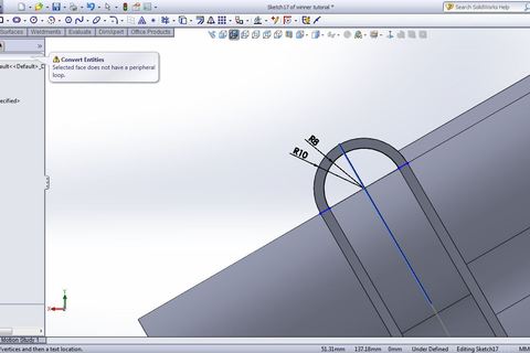

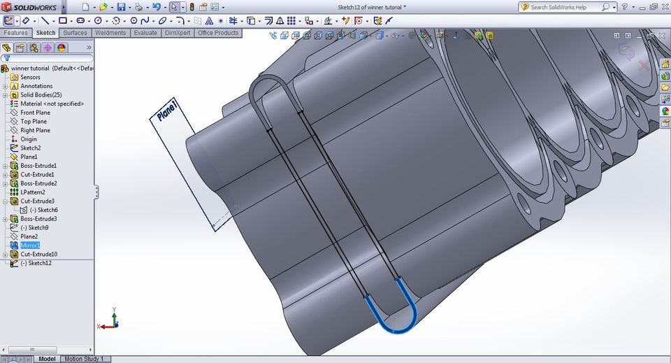

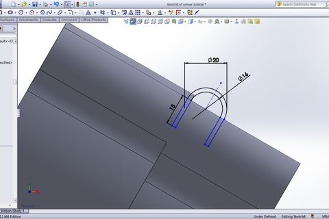

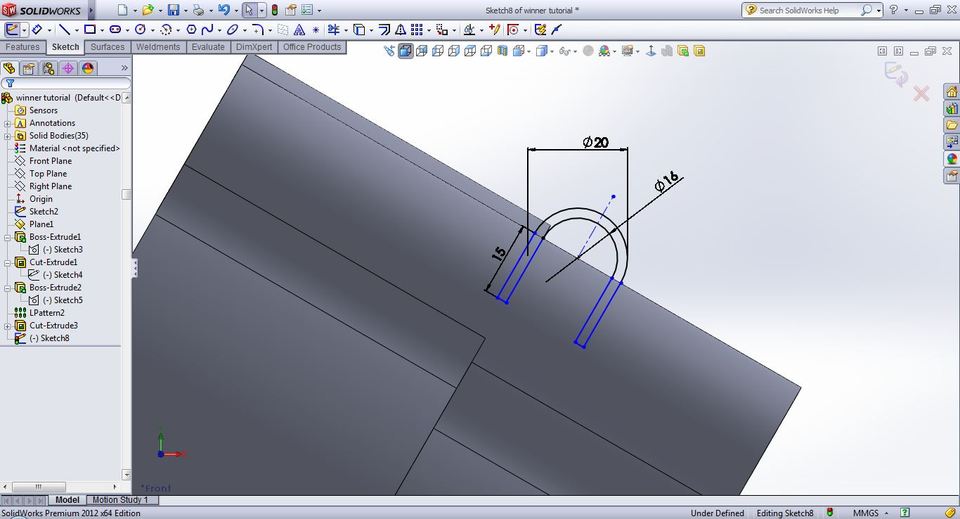

I'm having trouble while drawing the sketch of the water canal. Are the semi circles tangent to anywhere?

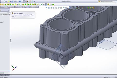

I'm making this in Inventor with little trouble, my only thing is -
I think hcortez is right that you need to clear out the drill holes.
Also, I cleared both edges of the canal because the coolant would flow only on the outside, so instead of 10mm cut I used 20. To make the profiles for the cut extrude, simply make a sketch on the face of the canal that's jutting in, and then use convert entities/project geometry and select the shapes that you don't want. Remove all constraints or relations, then use a linear replication (pattern) along a horizontal axis at 95 mm spacing to quickly make the shapes across the entire part. Finish the sketch and cut away.
