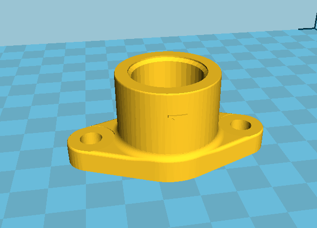

Hi frds,
This part i am done it from step file in solid works, Please tell me how to improve the surface finish for this part...
STL models are faceted by design of data format, so don't worry about that.

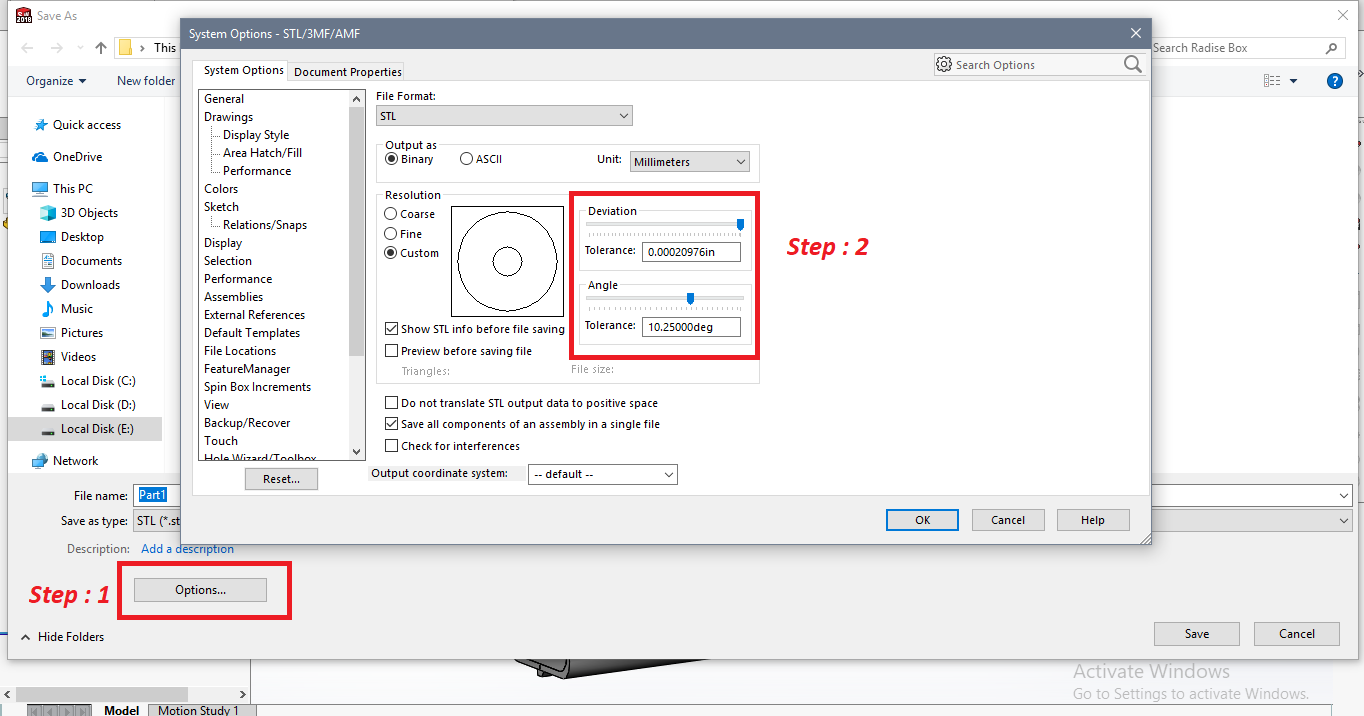

https://grabcad.com/aamer.nazir-1 is right. Depending on what software you use, there must be a setting to increase the mesh resolution. It's usually a button in the window where you "save as" or "export". Just go into the STL settings and play with the resolution.
