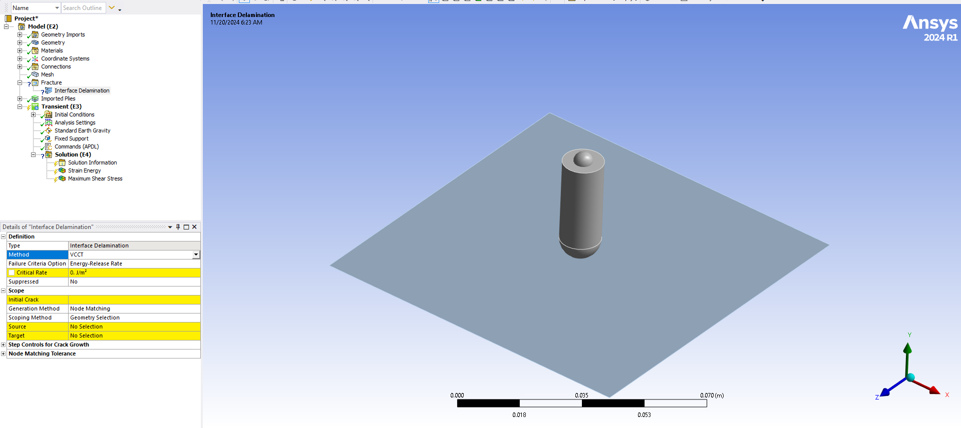

I need to check the delamination and determine absorbed energy of a composite due to an impact force. The subject material is modeled in ANSYS ACP.
I have tried through Fracture>Interface delamination. But as my composite is made in ACP, I can't relate the variables 'source' and 'target' with my model.
Can anyone help regarding this? Is there any other way?
